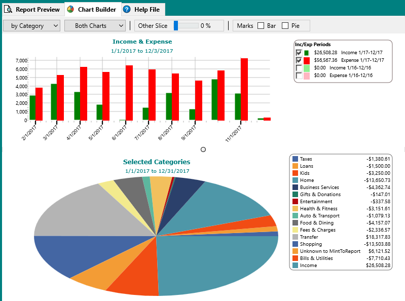

I have 2 charts separated by a splitter. The bar chart lets users select months, and that months categories are displayed in the bottom pie chart.
I want to make sure the user sees that clicking on the bar does indeed change the pie. I am new to Delphi Berlin (from Delphi 5) and am new to animations. I would like to create some sort of animation that will look like the pie chart is comming from the bar chart.
Any ideas how to accomplish this or any examples I could look at.
Attached is a screenshot of the charts.

Post by Yeray » Mon Dec 04, 2017 8:43 am
realsol wrote:Any ideas how to accomplish this or any examples I could look at.
There are some animations shipped with TeeChart. You can see a couple of examples under "All features\Welcome !\Tools\Series Animation" in the Features Demo program shipped with the binary installation of TeeChart Pro.

I downloaded the demo from https://www.steema.com/downloads/vcl. It was right where you pointed me. I want to do something also with the pie chart but didn't see any examples. The problem though is there is no source code where I can see how the animation is done. Where can I find that?
Re: TeeChart Animation
Post by Yeray » Tue Dec 05, 2017 10:14 am
The demo sources are shipped with the binary installation (evaluation version included).
