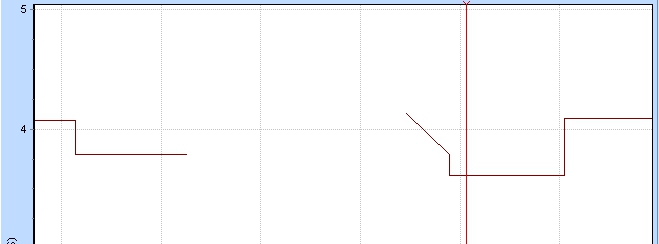

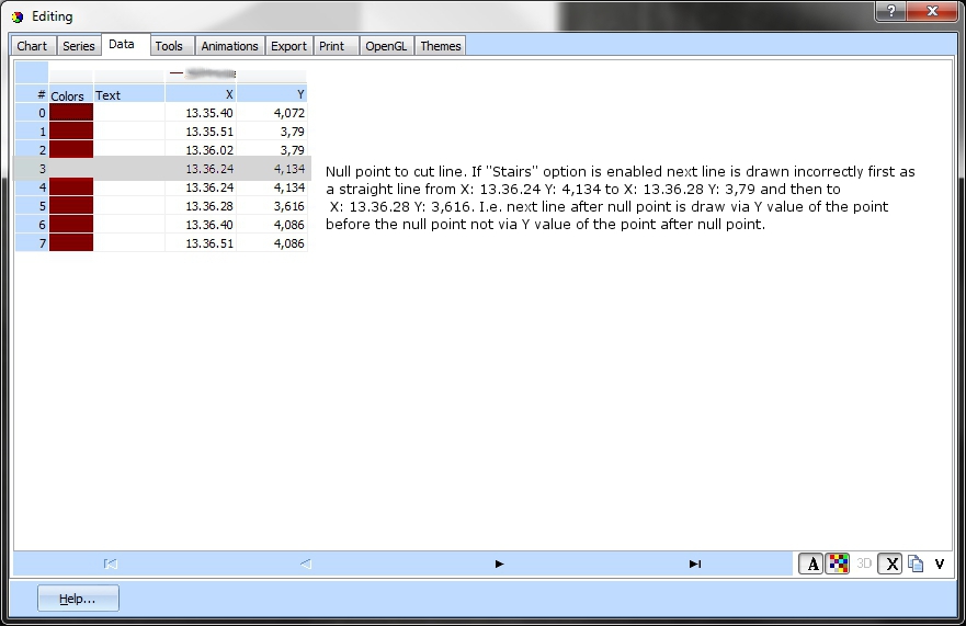

TeeChart 2012.0.0.9 ActiveX component. Line series with "stairs" option selected and null point in series to cut line. First line section AFTER null point from (x.1, y.1) to (x.2, y.2) is not drawn correctly (x.1, y.1 -> x.2, y.1 -> x.2, y.2) but using y value BEFORE null point i.e. (x.1, y.1 -> x.2, y.-1 -> x.2, y.2). Pictures of a sampe data and the resulting line series attached.

Sorry, I should have been more specific. Yeray, you are correct... the series is a FastLine series with "TreatNulls" property set to "Don't Paint" and "Stairs" property set to "TRUE".

Line is not drawn correctly. We did not have this problem with TeeChart ActiveX 8 with the same code.
