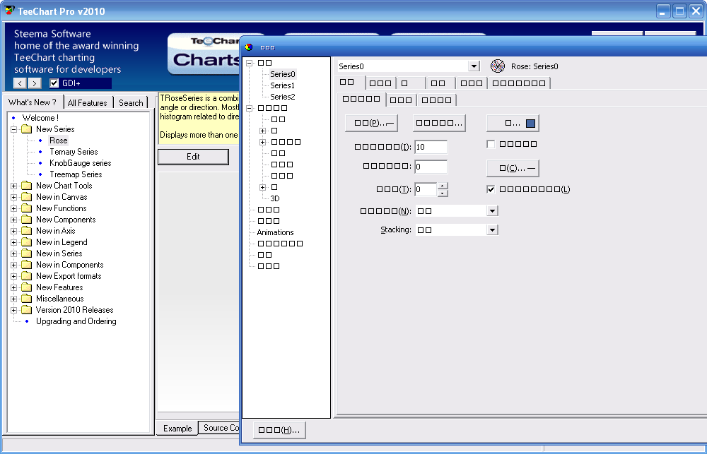

I have characters problem with Teechart v2010 Editor:
How can I solve this issue ?
Thanks for your help

Additional informations: on the same machine, I don't have this issue with Teechart v8 component
Hope it can help

Solution:
TChart1.Language = English

Hi Guliz,
Right clicking on a chart at design time in you IDE you can change the default language set in the registry and it will be used in the features demo,...
