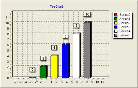

Can someone try the VB code below?
The first bar has a X value of "0", but appears on the plot at approximately -3. What is going on?

Thinking a little bit further about this issue, the stacking algorithm will work correctly *only* if all series have the same number of points and point x values coincide. If this is not the case, you'll have to use AddNullXY method to add "missing points". I'd use the following approach:
1) Make a list of all available (pool) of x values.
2) For individual series, cycle through (1) and use AddXY if point (x,y) exists and AddNullXY if specific point (x,y) does not exist for this series.
An easier alternative is setting MultiBar to mbNone, for example:
Private Sub Form_Load()
    Dim i As Long
    TChart1.RemoveAllSeries
    For i = 0 To 5
        TChart1.AddSeries scBar
        TChart1.Series(i).asBar.MultiBar = mbNone
        TChart1.Series(i).asBar.BarWidthPercent = 20
        TChart1.Series(i).AddXY i, i * 2, "", TChart1.Series(i).Color
    Next i
So we have closed the issue in the bug list.

This is how stacked series are designed. For stacking to work you need to have same number of points in all series and all of them should have same X values. Setting Multibar to mbNone doesn't label series wrongly but it may be nicer in 2D. There are 2 options here:
1. Set MultiBar to none and the chart to 2D view:
    Dim i As Long
    TChart1.Aspect.View3D = False
    For i = 0 To 5
    Next i
2. Add same X values for all series setting to null the points which should not be displayed in the chart.

Yes, I understand but by default Bar series are set to MultiBar = mbSide. That's why I'm saying that if you are using several bar series the way you are you should either set MultiBar to mbNone or add null values where necessary. Actually, the example you sent would be easier using one single bar series, you can already have a different color for each series:
    Dim i As Long
    TChart1.Series(0).asBar.BarWidthPercent = 20
    TChart1.Series(0).ColorEachPoint = True
    For i = 0 To 5
        TChart1.Series(0).AddXY i, i * 2, "", clTeeColor
    Next i

Another option is setting Multibar to mbSideAll:
  Dim i As Integer
  For i = 0 To 5
    TChart1.Series(i).asBar.MultiBar = mbSideAll
  Next i
