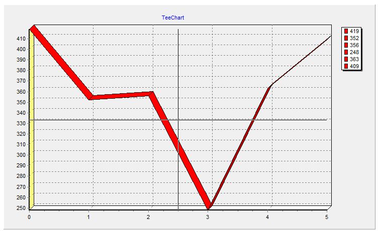

If you take this code, you will see an error from Line 11 "Object required: 'Axis'" and also there is a Cursor tool added. I also attached a screenshot to show the Cursor on the chart.

You need to do as in the code snippet below as some constants might not be defined.
    <html><head><title>GridBand chart</title></head>
    <body>
    <script language="VBScript">
    Sub Window_onload()
    With TChart0
        .AddSeries scBar
        .Series(0).FillSampleValues 6
        .Tools.Add 16 'tcGridBand
        With .Tools.Items(0).asGridBand
            .Axis = 0 'aLeft
            .Band1.Color = 16250354
            .Band2.Color = 16116201
        End With
    End With
    </script>
    <object id="TChart0" CODEBASE="teechart7.cab" TYPE="application/x-oleobject" width="100%" height="100%" classid="CLSID:FAB9B41C-87D6-474D-AB7E-F07D78F2422E" ></object>
    </html>
