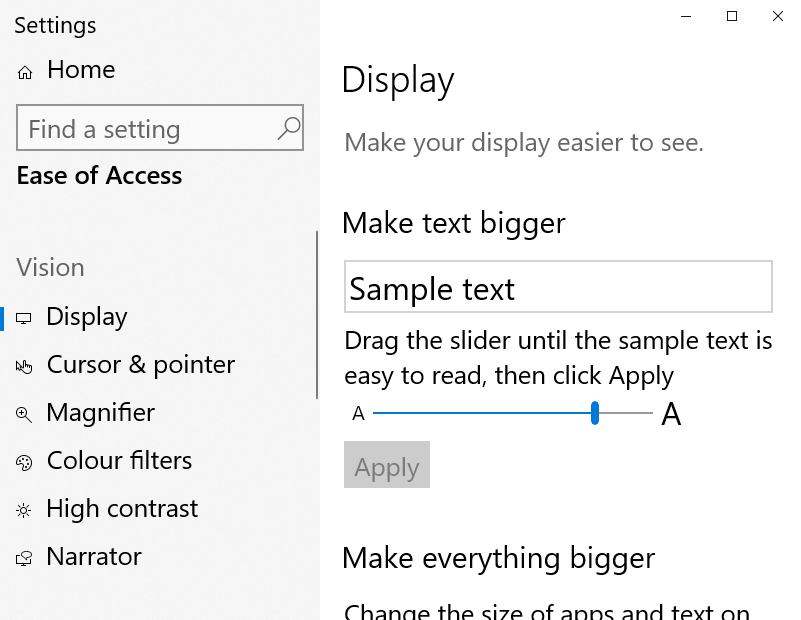

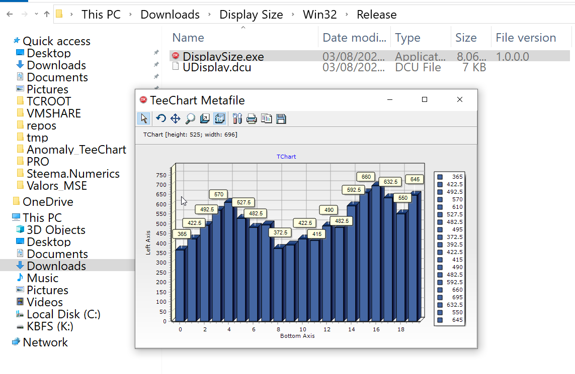

I'm not sure if I'm doing this right - I compile your project in release mode, then I change the display font size like this:
Then I run the exe and get this:
Could you please confirm or otherwise correct me on whether I'm doing this right?
EdDressel
Posts: 35
Joined: Mon Nov 25, 2019 12:00 am
Re: Display settings and font size
Post by EdDressel » Mon Aug 03, 2020 2:07 pm
That is similar to what I am doing, but I am using Delphi 10.4. Did you try that?

One thing I thought we could try in the meantime is exchange *.exes - I send you the Release build I create here to see if it behaves the same at your end, and you send me yours. In this way we should be able to determine if it's the build version of Delphi that's at issue or not.
Here's mine:
http://www.steema.com/files/public/support/Win32.zip
EdDressel
Posts: 35
Post by EdDressel » Tue Aug 04, 2020 7:29 pm
Good thinking.
I am off site but have my laptop with a high-density display--I ran both programs: my compiled program reproduces the problem, your compiled program does not have the problem.
