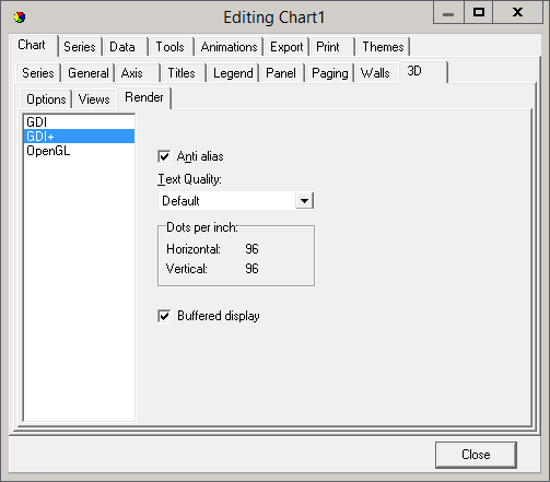

TeeChart VCL supports three Canvas: GDI, GDIPlus and OpenGL
TeeChart 2013.09 moved the default Canvas from GDI to GDIPlus (see the What's New page). This is for new charts being created while the charts already present in old forms should keep their choice.
However, you can still:
  • Change the current chart's canvas:
    • Through the editor at the "Chart/3D/Render" tab:
    • By code
      To set GDI by code:
      uses TeCanvas;
        Chart1.Canvas:=TTeeCanvas3D.Create;
      To set GDIPlus by code:
      uses TeeGDIPlus;
        Chart1.Canvas:=TGDIPlusCanvas.Create;
  • Change the option for the next new charts to be created at the "New Chart" tab in the "Options..." dialog opened from the contextual menu at design time::
