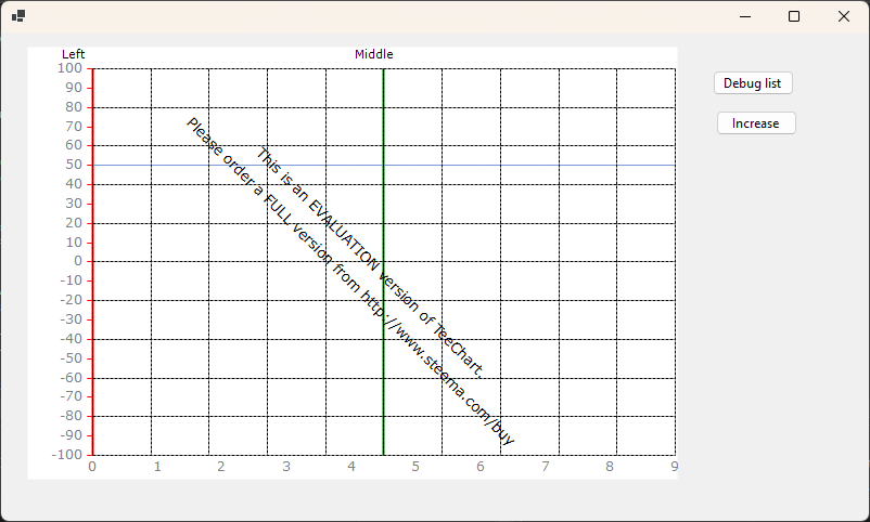

And this is how it would look like:
You can find more information in our docs: https://www.steema.com/docs/TeeChartNETTutorials.htm (Tutorial 4, "Axis Control")
If this approach doesn't work for you or if you need anything else, let me know!
