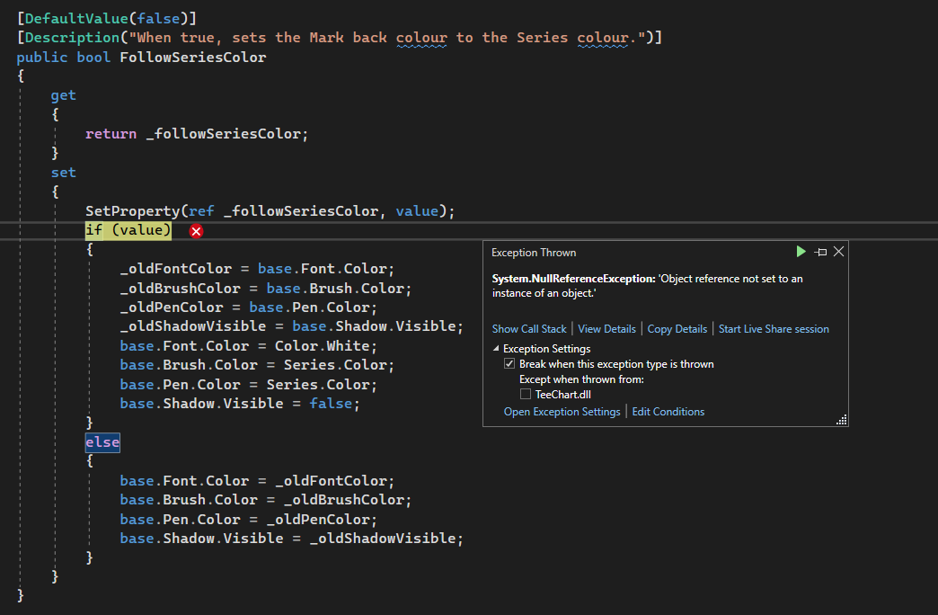

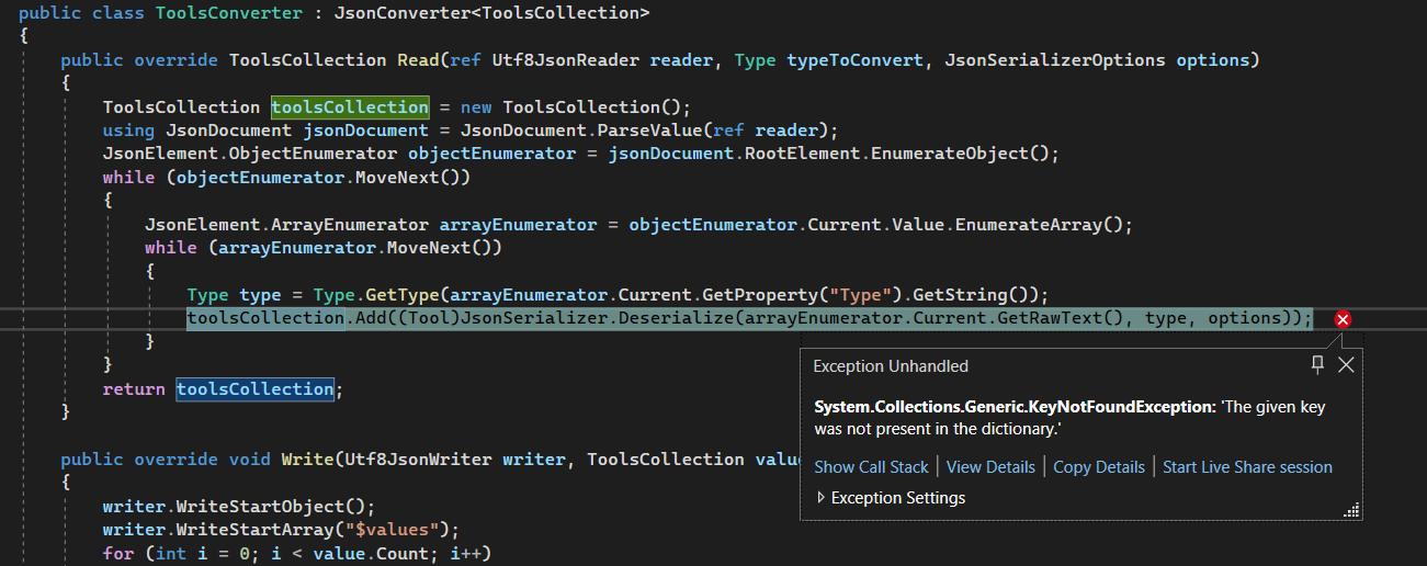

I am exporting a template and trying to import it back and it crashing. There are two pieces of code which seem to crash the loading of the template. First is line.Marks.FollowSeriesColor = true in the code below and the second is tChart1.Tools.Add(new Steema.TeeChart.Tools.CursorTool()); The code is below and i have commented out those two lines and it seems to work. When adding each line it crashes.

Hi Marc,
It seems to crash here. I have attached screenshots when running in debug mode where it crashes. I created a winforms application with these files in it. Let me know if you can reproduce it with this.

Post by Marc » Wed Nov 08, 2023 4:50 pm
Thanks you for the extra info. I can reproduce the error in a fresh project. My test project may be hanging on to a cached-package reference; I'm checking for differences and cause.

Post by Marc » Tue Nov 14, 2023 10:02 am
As a follow-up, A fix has been applied to TeeChart code to be included with the next update release.
