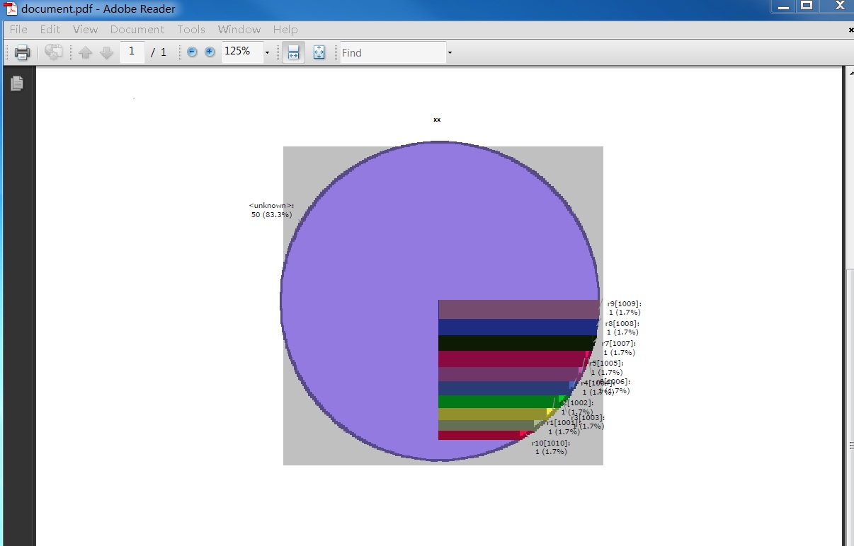

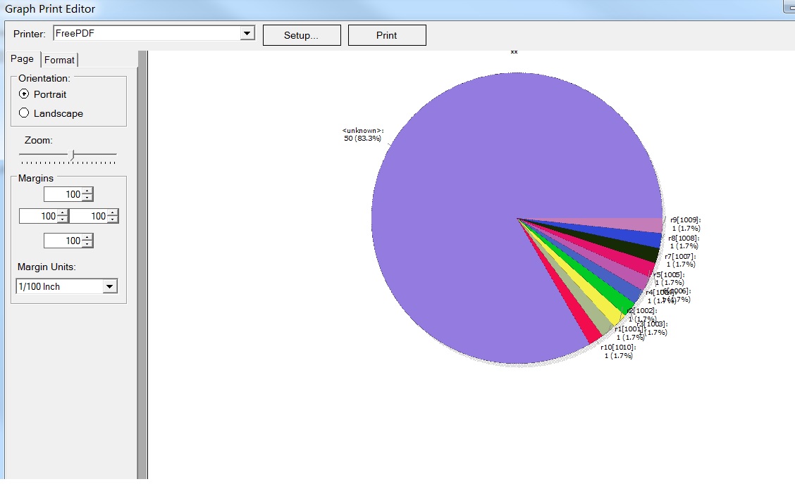

we are using TeeChart (4.1.2012.9283) component in our .NET application, we use TChart.Editors.EditorUtils.ShowFormModal to invoke "Graph Print Editor" dialog thus user can print pie chart to PDF (by selecting a PDF product in printer listbox), we found the Pie chart in PDF is not shown correctly, it occurs for serveral PDF tools including FreePDF, Adobe Acrobat Pro and CutePDF.
i attached two image of how pie chart is shown in PDF.
As the error will be shown in several PDF tools, so i want to know is this a known issue, are there any ways to fix (or workaround) it?

- this is problematic pie chart
- error.jpg (86.63 KiB) Viewed 7655 times
- this is expected pie chart
- normal.jpg (87.97 KiB) Viewed 7649 times

Hello Xin,
This issue is already registered in our issue tracking software with id=1312. Many apologies for any inconvenience this issue causes. We will look into fixing this issue before the next maintenance release.
