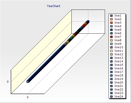

Dear,
When I add more then 25 lines in my chart which all have only 1 point, my 3D chart looks strange.
This my code:
chartToTest.Aspect.View3D = true;
            for (int i = 0; i < 30; i++)
               Steema.TeeChart.Styles.Line line = new Steema.TeeChart.Styles.Line(chartToTest.Chart);
               line.Pointer.Visible = true;
               line.Add(0, "");
Kind regards
3D chart.PNG (17.77 KiB) Viewed 12686 times
Re: 3D chart loses axes
Post by Sandra » Tue Jul 02, 2013 8:46 am
Hello OMP,
Using your code with latest maintenance release of TeeChartFor.Net ( Build 4.1.2013.05281):
    //  tChart1.Dock = DockStyle.Fill;
        Steema.TeeChart.Styles.Line line = new Steema.TeeChart.Styles.Line(tChart1.Chart);
        line.Add(0, "");
I have gotten next results where your problem doesn't appear.
Could you please tell us which version of TeeChartFor.Net are you using?

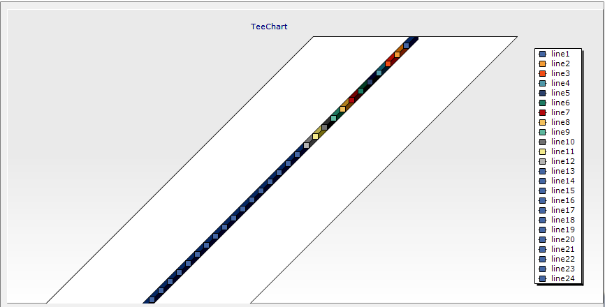

Post by OMP » Tue Jul 02, 2013 10:20 am
I have downloaded the latest version (4.1.2013.5282) and tried it again, but the issue still remains.

OMP
Posts: 21
Post by OMP » Tue Jul 02, 2013 1:07 pm
When I was making the test project, I have noticed that it depends on the size of the window and the number of lines that are used.
In the test project I couldn't reproduce it with 30 lines, but when 50 lines are used, the issue is still there.
I will send the test project to support.
Post by Sandra » Wed Jul 03, 2013 10:18 am
Hello OMP,
We consider it as an enhancement and for this reason we have added it in wish-list with number [TF02016632] to we will consider its inclusion in future maintenance releases of TeechartFor.Net.
