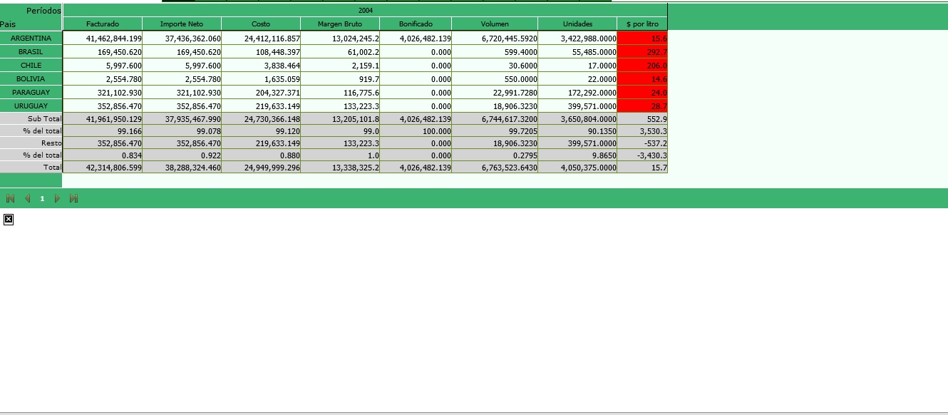

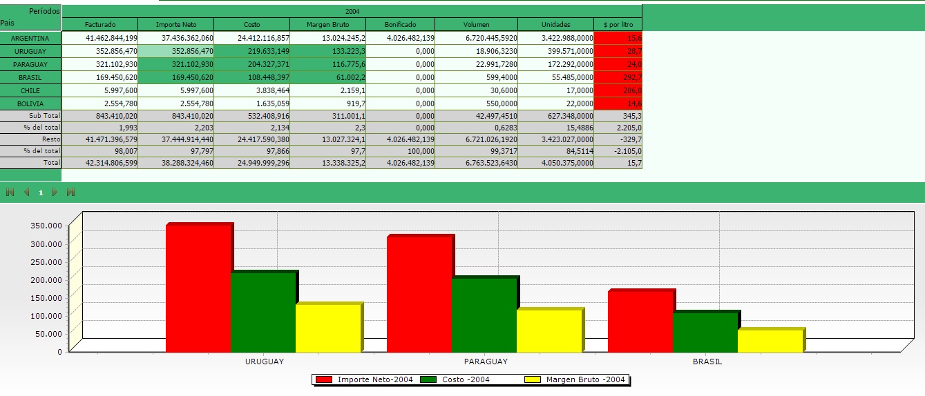

Hi, I have an strange problem since I've updated to 4.1.2015.12164.
The Chart is showed in Chrome (Versión 48.0.2564.116 m) but not in Internet Explorer (Versión 11.0.9600.18205).
Thank you
Problem with browser when update to 4.1.2015.12164
- IE 11
- IE11.jpg (139.29 KiB) Viewed 11187 times
- In Chrome
- ThreePoints.jpg (197.05 KiB) Viewed 11178 times

Hi, the version was the immediately before, we always update when an update arrived.
Because we needed to make a demo, I discovered that when there is not a connected net on the notebook, the problem not exists.
Is something with the image temporary directory, but I don't figure what.
<tchart:WebChart ID="WebChart1" runat="server" Height="400px" Width="1200px" Style="position: relative" AutoPostback="False" GetChartFile="GetChart.aspx" TempChart="File" Config="AAEAAAD/////AQAAAAAAAAAMAgAAAFFUZWVDaGFydCwgVmVyc2lvbj00LjEuMjAxNS4zMTE0LCBDdWx0dXJlPW5ldXRyYWwsIFB1YmxpY0tleVRva2VuPTljODEyNjI3NmM3N2JkYjcFAQAAABVTdGVlbWEuVGVlQ2hhcnQuQ2hhcnQDAAAADC5DYW5jZWxNb3VzZRAuQ3VzdG9tQ2hhcnRSZWN0GS5Bc3BlY3QuQ29sb3JQYWxldHRlSW5kZXgAAAABAQgCAAAAAAAAAAAACw==" />
WebChart1.TempChart = Steema.TeeChart.Web.TempChartStyle.Session;
regards
regards
