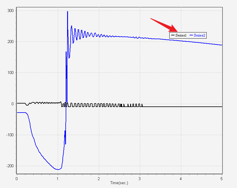

Post by » Mon Jul 24, 2023 1:32 am
How to prohibit dragging legends?

I don't understand what do you mean. The legend isn't draggable by default.
Could you please expand?

Why is it possible to drag by default?
How to prevent the legend from being dragged?
Sorry but it should not be draggable by default.
Check the code and the form in your project.
If you still find problems with it, please arrange a simple example project we can run as-is to reproduce the problem here.

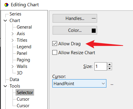

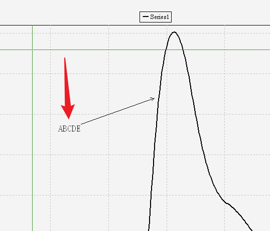

I found the reason。
I added a selection tool to achieve drag and drop annotation functionality。
This causes the legend to also be dragged. How to solve this problem???

Indeed, the TAnnotationTool doesn't support dragging. However, the TRectangleTool does.
So, instead of having a TAnnotationTool and adding a TSelectorTool to add dragging support to it, you could just use a TRectangleTool.

Due to requirements, I can only use Annotation. How can I prevent dragging legends?
Please provide a demo of c++builder。
Re: c++builder How to prohibit dragging legends
Post by Yeray » Fri Jul 28, 2023 2:27 pm
You can't make the TSelectorTool not to detect the Legend. So, instead of using the TSelectorTool, I'd implement the TAnnotationTool dragging myself.
