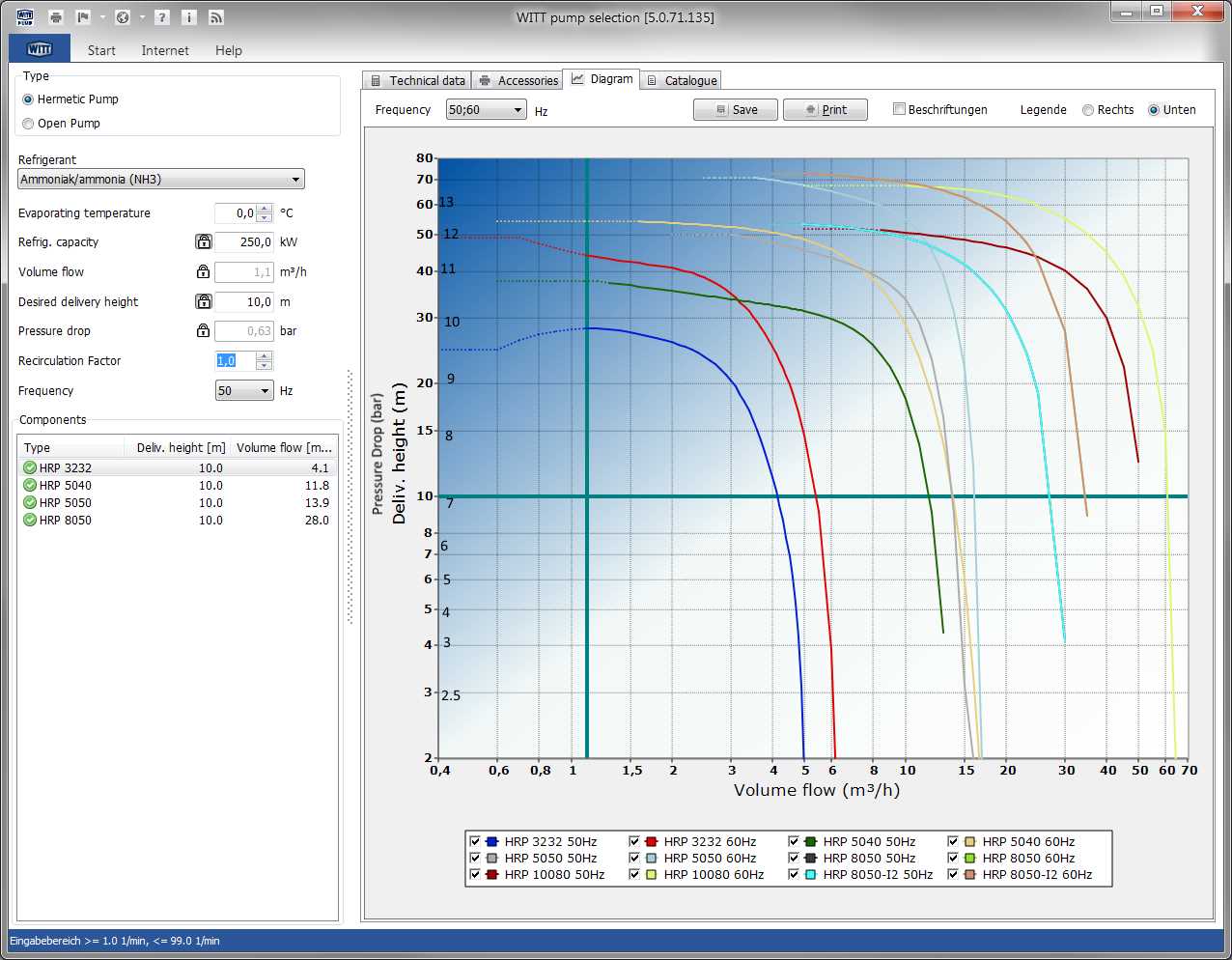

Is it possible to use two sets of labels (e.g. to display two different units) for the same axis or achieve this by some other feature? I attached a picture to illustrate the desired effect.
Thanks!

Yes, there are two options here:
1. Using the two default vertical axes like this:
uses Series;
var i, j: Integer;
  for i:=0 to 2 do
    Chart1.AddSeries(TLineSeries.Create(Self));
    Chart1[i].VertAxis:=aBothVertAxis;
    for j:=0 to 100 do
      Chart1[i].Add(random(100), 'point ' + IntToStr(j));
  Chart1.View3D:=False;
  Chart1.Axes.Right.PositionPercent:=100;
  Chart1.Axes.Bottom.LabelStyle:=talValue;
  Chart1.Axes.Right.Increment:=10;
2. Use SubAxes as explained in the Whats' New? page. I also posted an example here.

That's exactly what I was looking for. Thank you!
