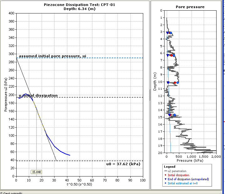

Here are 2 images to see how the new charts appear after importing the project file to XE6 (no code changes).
- Xe6.png (137.15 KiB) Viewed 33107 times
- D2007.png (86.2 KiB) Viewed 33101 times
