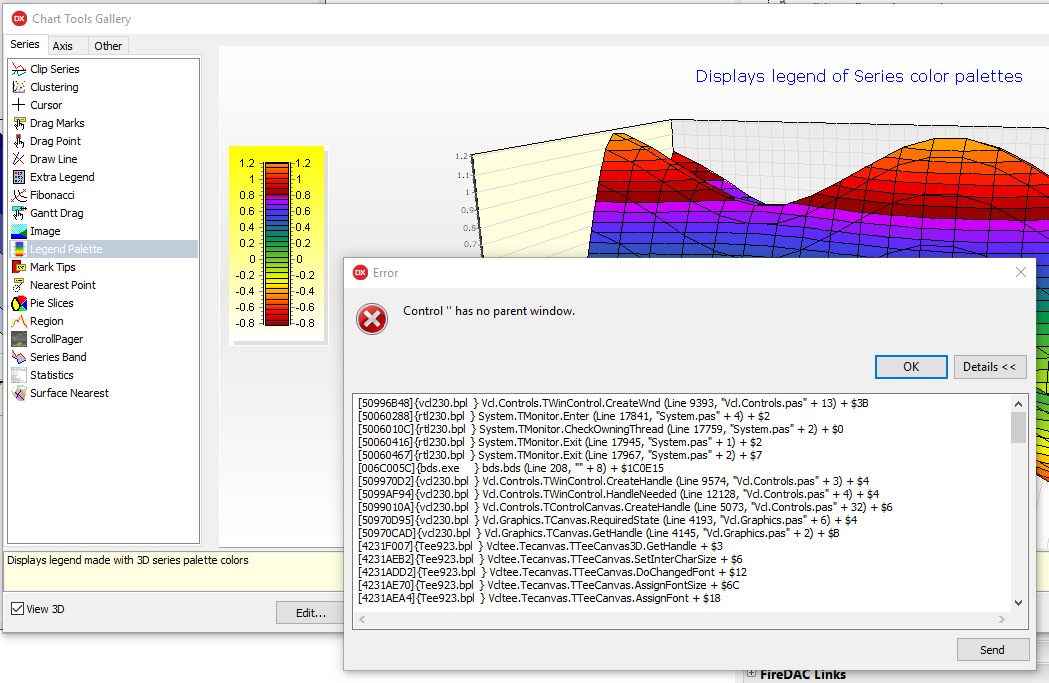

I just upgraded to the latest TeeChart VCL 32 bit version and I am still having issues with the Legend Palette, once this object is added to a chart and the mouse goes inside the chart area I get this error message. Can you please provide some guidelines on how to identify and fix this issue?

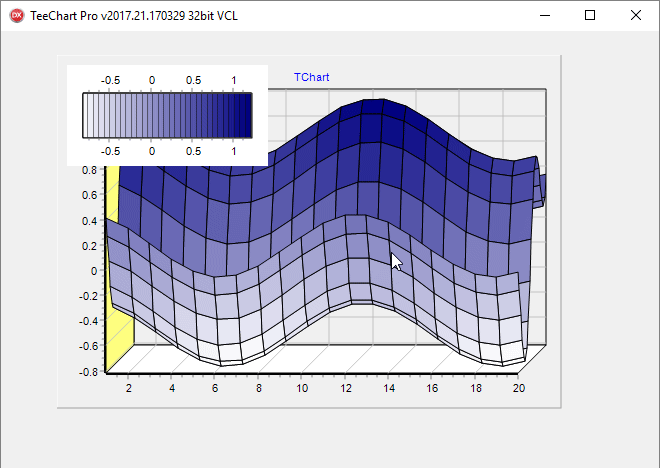

johnnix wrote:I can only send you an executable that generates the error, if I send you the code you will not be able to reproduce is (just like the first time I reported this!)
I guess you mean here. Indeed, it seems I wasn't able to reproduce the "Control '' has no parent window" error at that time either.
This is what I see with that exe. I can't find how to make it to crash:

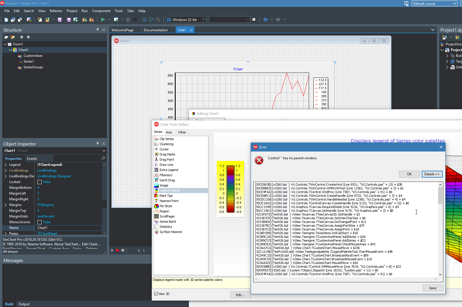

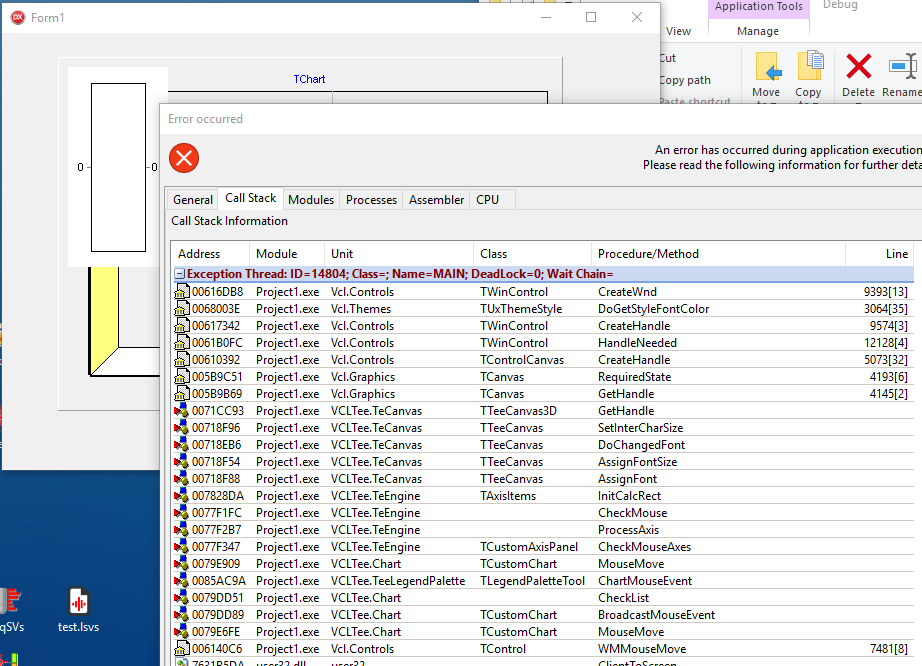

Wow, how can this be possible? When I move the mouse over the chart I get the error (I included a screenshot from EurekaLog running, maybe someone could have some idea?)
Yes, the issue appeared with my Delphi XE7 version but after I upgraded to XE10 with a clean install I thought it would "magically" go away as it was almost obvious that this is an issue with my installation.... If anyone has any idea about this please let me know, I removed the legend palette from my app and wish to include it again.

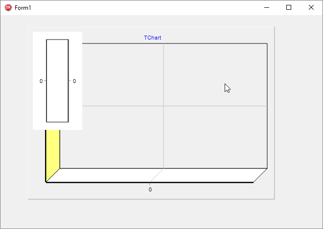

Post by Yeray » Fri Apr 21, 2017 9:40 am
This is how it works for me:
