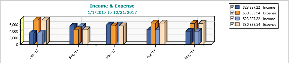

How can I keep this chart from overlapping each other? I have them set on the series to display side by side. See attached.

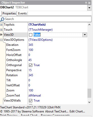

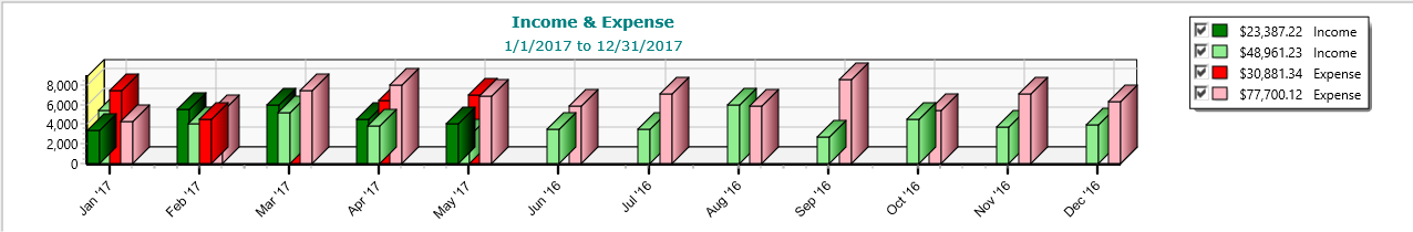

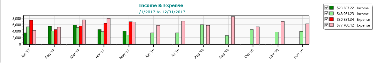

If I set View3d to false, all the bars line up like they are suppose too. Here are 3 images.
1. Chart in 3d
2. Chart without 3d
3. My chart 3d settings

I would like inform you that the problem occurs when is set the Xvalues property Order to Descending. Therefore, as a workaround, I would suggest you set the XValues order for each series to None. The code below shows you how:
  Chart1[0].XValues.Order := loNone;
  Chart1[1].XValues.Order := loNone;
Hoping this helps you.
Thanks in advance
