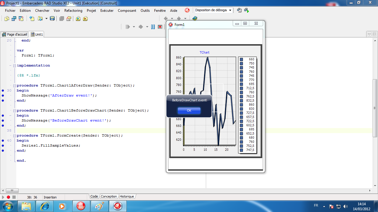

I'm trying to reproduce this in XE2 and the actual sources in a Win7 x64 machine but it seems to work fine for me here. Find attached the application I'm using. When the application starts, I see a call to both OnBeforeDrawChart and OnAfterDraw events but not when I move the mouse over the chart once it is shown.rlebbar wrote:By putting a showmessage on BeforeDraw and on AfterDraw i noticed that drawing keeps get called every time, as soon as you move the mouse, consuming CPU which is ok on windows but not on ios. Please note that no data has been modified or a form resized, just moving the mouse !
I hope that you can find a workaround to not let the TChart be redrawed unnecessarily !

Hi Yeray
Please look at this image !
- Your Project
- Event.png (163.43 KiB) Viewed 40113 times
