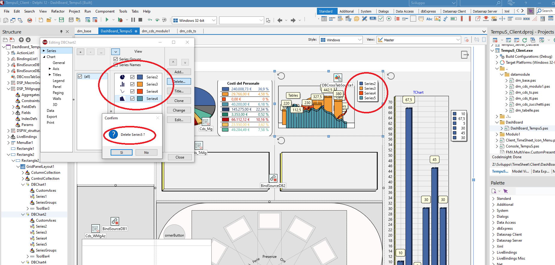

1) If I create multiple series in the groups and delete one from that moment the series counter displays the references incorrectly
(serial number error.png)

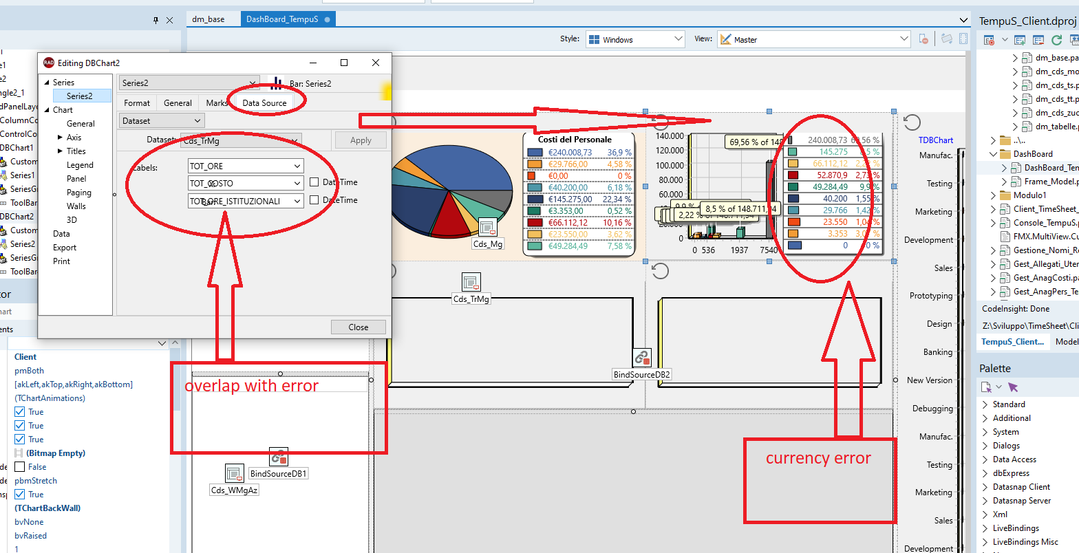

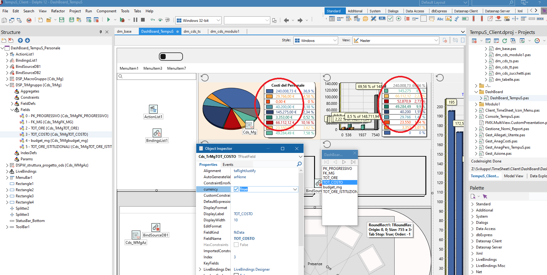

2) A persistent field of a tclientdataset set to currency is reported correctly if used in the label if used as the value of X the format is lost
(currency error.png)

Re: reporting two tdbchart bugs
- The
- The
Maybe we should save an internal
In the meanwhile, you could make sure you set a
When you create a series, no
Name
is set to it by default. And when a series doesn't have a Name
set, both the legend and the TChartListBox
(used to draw the series list in the Editor) use the SeriesNameOrIndex
function to calculate a string to draw each item. Then, the issues here are:- The
SeriesNameOrIndex
method gives Series1
always for the first series. If you remove the first series, then the next series will be Series1
.- The
TChartListBox
doesn't refresh when you remove a series. That's why the Editor and the Legend look out of sync. If you close the Editor and reopen it, they should be in sync again.Maybe we should save an internal
Name
when a Series is created, in a similar way as we do with the Series Color
, where we use a internal ISeriesColor
property. I've added it to the public tracker (#2694).In the meanwhile, you could make sure you set a
Name
property in your series. Ie using the GetNewSeriesName
function:
for i:=0 to nSeries-1 do
with AddSeries(TBarSeries) do
Marks.Hide;
FillSampleValues;
I'll take a look at this asap.

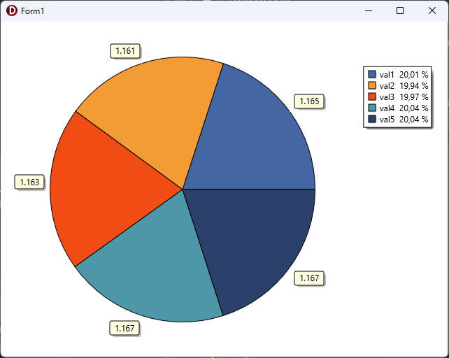

I'm trying to reproduce the problem in a simple example project without success.
This is the closest I can get to your screenshot with a simple example:
Could you modify the example above, or arrange a simple example we can run as-is, so we can reproduce the problem here?

I tried to reproduce the error as best as possible, I will send you the structure and data of the table in csv format
and 2 screenshots explaining how to reproduce the problem.
I didn't write code but just used DBCHART objects and a clientdataset
I remain available to help you

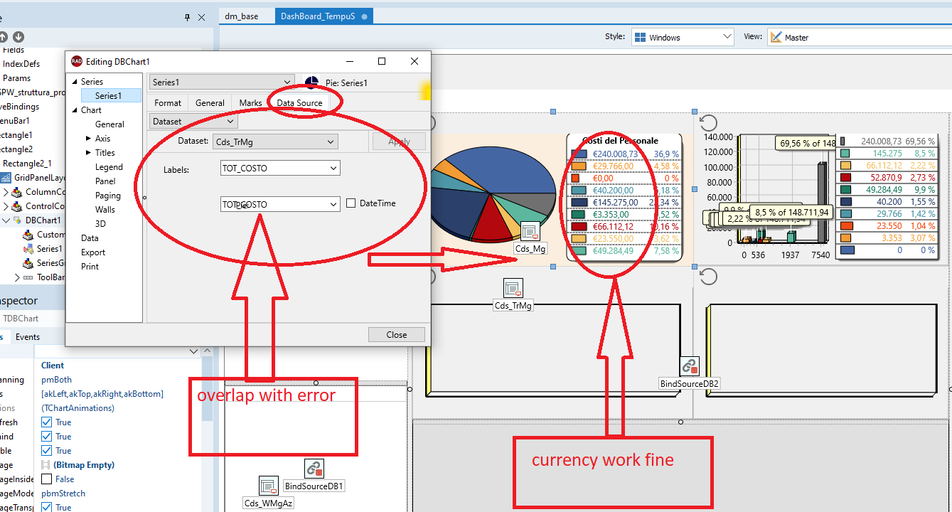

- DELPHI 12.1 form FMX
- currency error.png (133.77 KiB) Viewed 114740 times
- currency work fine.png (125.17 KiB) Viewed 114740 times

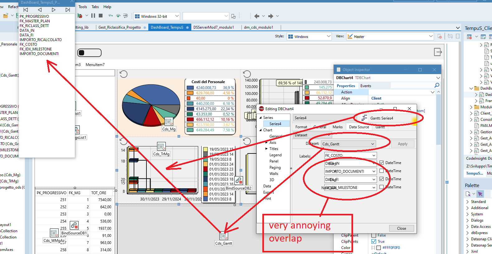

to supplement my report ": reporting two tdbchart bugs" (no response from you about this)
I attach a screenshot of a persistent and annoying label overlap when using the comboboxes for setting a dataset
Ciao
Raffaele Barone
Ciao
Raffaele Barone
- overlap label
- overlap.png (153.65 KiB) Viewed 114656 times

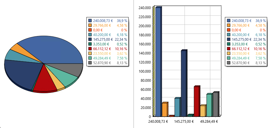

Hello Raffaele,
I've done a simple example in code using your dataset:
And this is how it looks for me here:
Could you please give it a try?
Regarding the problem in the Dataset Editor, where some
TLabel
s overlap some TComboEdit
s, I've added it to the public tracker: #2700 and I've already fixed it for the next maintenance release.Best Regards,

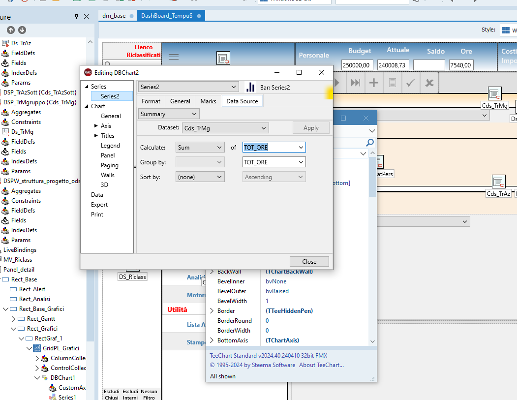

- TeeChart
- series summary apply not enable.png (83.21 KiB) Viewed 114032 times

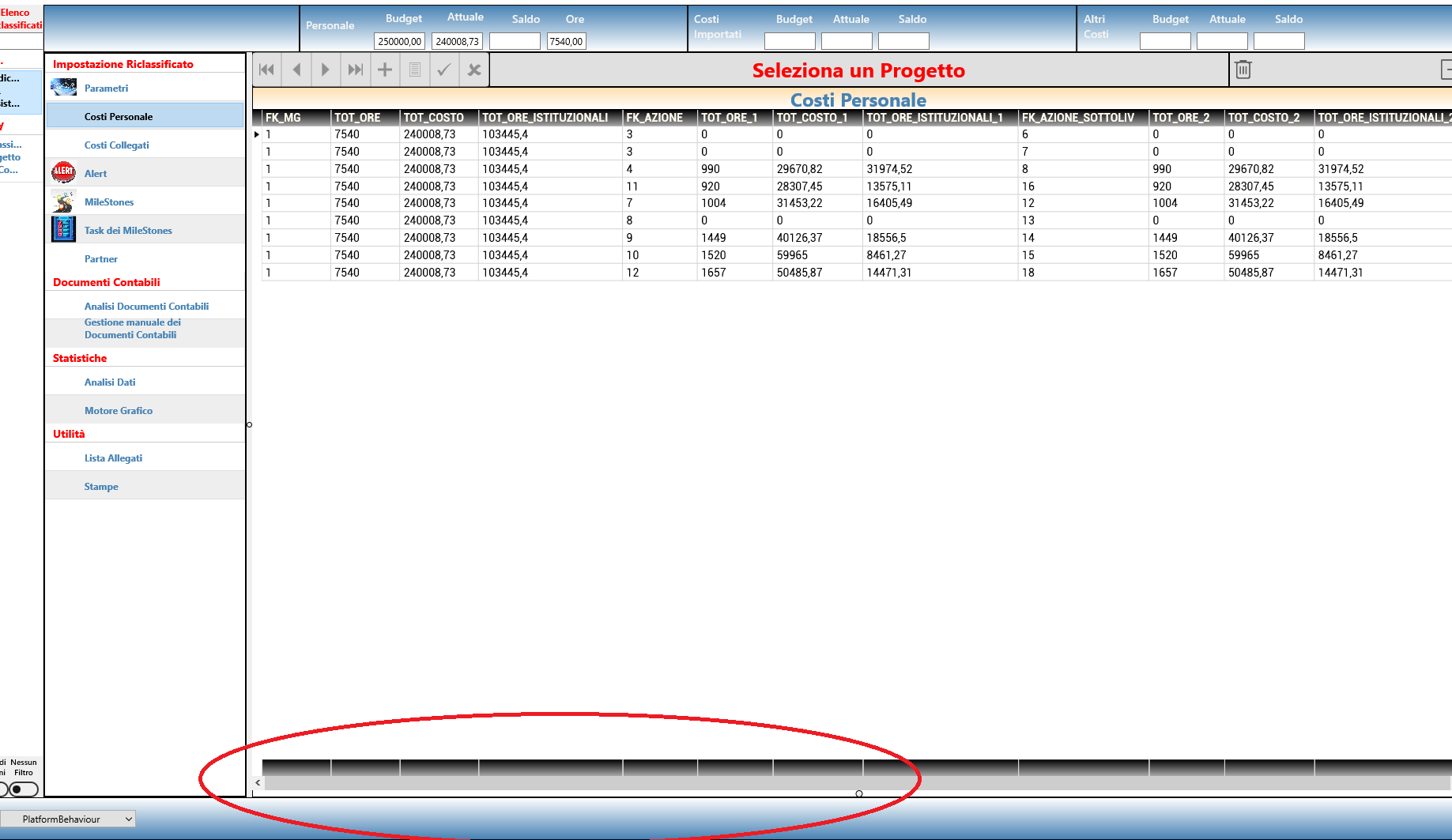

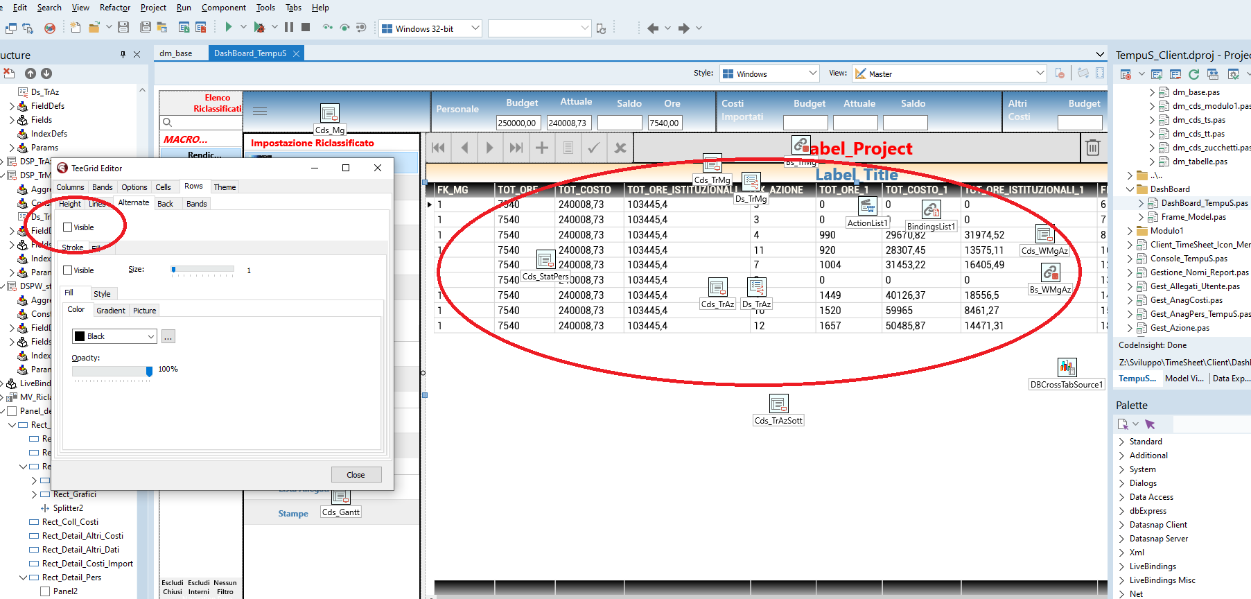

reporting teegrid bugs

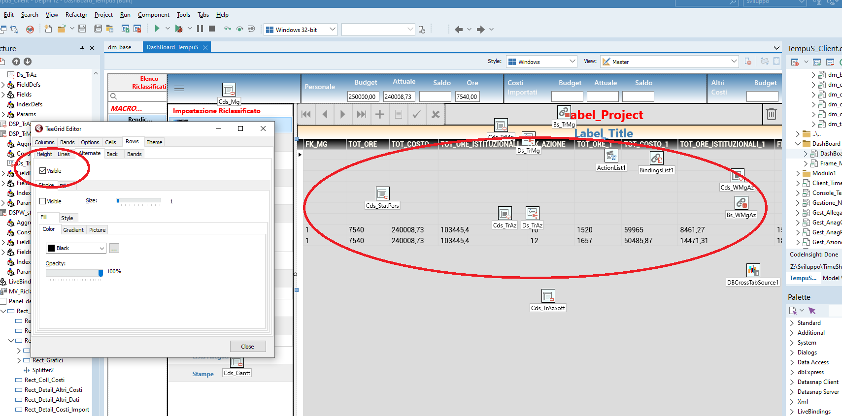

as I told you in the previous post, TeeGrid on FMX suffers from several bugs
I'll point out another one regarding the alternating colors on the row
Ciao
Raffaele
Ciao
Raffaele
- Teegrid Row Alternate enable.png (151.92 KiB) Viewed 114003 times
- Teegrid Row Alternate disable.png (196.05 KiB) Viewed 114003 times
