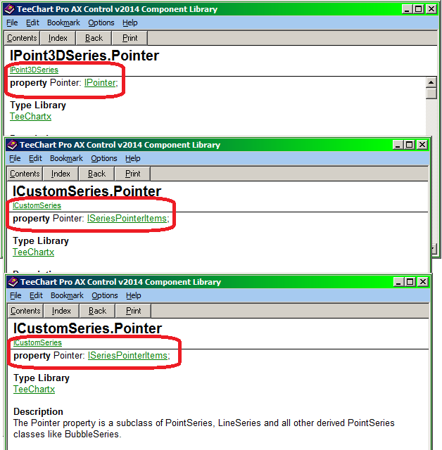

And looks like series IPointer3DSeries.Pointer is kept the same as before but ICUstomSeries.Pointer (series line and point) are changed to type ISeriesPointerItems.
- pointer_types.png (31.32 KiB) Viewed 30667 times
