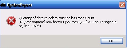

Problem - We keep adding data for line graph every second. When it reaches more than 15000 X-axis elements we delete the first point and add new point at the end for sake of displaying latest data. It used to work fine in TChart6 but as soon as we shifted to TChart2013 and kept it for overnight test it started to display message "Quantity of data to delete must be less than Count" for infinite times.
Check the attached jpg file.

Displayed error message

This exception is thrown in the Delete method, which deletes Quantity number of points from Start index, when (Start+Quantity-1) < Count. This error message would indicate that you are trying to remove more points that those existing in the series. I have done some tests here and it works fine. Can you please check that this is not the case? If the problem persists please attach a simple example project we can run "as-is" to reproduce the problem here.
