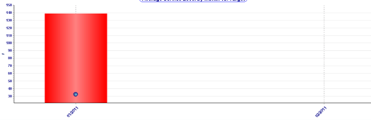

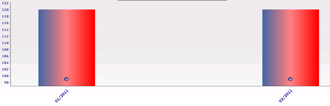

we are testing the new activeX version 2010. we currently use v7.
in v7 we designed the charts template to have certain colors. for example red and green.
when we use the new version 2010, there is a change in the colors (please see the attachments)
there are 2 attached files:
1. tee chart 7 - this contains the colors we designed - gradient red
2. tee chart 2010 - this contains how it looks using the new version (the colors are NOT looking OK)
why is that, and how can we solve it ?
10x

- tee chart 2010
- 8.0_red.png (14.82 KiB) Viewed 23505 times
- tee chart 7
- 7.0_sp1_red.png (11.46 KiB) Viewed 23485 times

Hello Oblicore,
I could reproduce your problem and I have added it in bug list report with number [TV52015384]. We will try to fix it for next maintenance releases of TeeChartVCL. On the other hand, for now you can assign the EndColor, changing default color of BarSeries as you want. For example, if you want EndColor=Blue you only must assign Bar.Color= Blue as do in next example:
I hope will helps.

I have communicated that bug (TV52015384) is not a bug. In version of TeeChartActivex 2010 we change the default themes, so the Gradient looks different. If you want get the same result that you had in version 7 you only change the theme of Chart for Default TeeChart as do in next example:
I hope will helps.
Private Sub Form_Load()
TChart1.AddSeries scBar
TChart1.SetTheme ctDefault, cpTeeChart
TChart1.Series(0).asBar.Gradient.Visible = True
TChart1.Series(0).asBar.BarStyle = bsRectGradient
TChart1.Series(0).asBar.Gradient.StartColor = vbRed
TChart1.Series(0).asBar.Gradient.MidColor = vbWhite
TChart1.Series(0).FillSampleValues (2)
