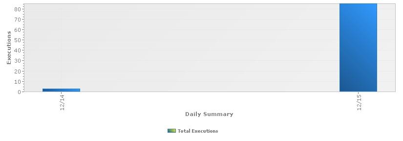

We recently upgraded from version 7.x to 9.x. Some property defaults have changed apparently. Previously, we had bar charts with gradient bars and the legend symbols for the series were not displayed with a gradient. Now they are always displayed with a gradient, but the gradients in the legend DO NOT match the gradient of the bars. Only a small corner of the symbol matches the bar. The rest of the symbol shows a very light color. I can set my own gradient for the symbol using .Legend.Symbol.Gradient.StartColor, MidColor, EndColor, but that only works if we have only one series because this setting is global to the chart and not specific to the series. If I have multiple series then this setting just affects the center of the symbol. This problem is most obvious with server-side charts rendered as images. With a .Tee file and client-side ActiveX, I did not have this problem with one series. It looked fine. But with multiple series the problem exists even with ActiveX. Our code-base is too large for a simple code example. If it is not clear what the problem is, can you send me a simple bar chart example generating an image file and I'll modify it if needed to demonstrate the problem. I am attaching an image that shows the symbol without any code changes that does not look like the bar series.

I'm trying the following code in a VB6 application with v2011.0.0.4. Both the picture and the chart shown in the screen show the correct gradient both in the bars and the legend symbol.
However, I've seen that removing the line where the exportation is done, the chart is repainted one time less and the chart shown in the screen shows a correct gradient in the bars but no gradient at all in the legend symbols. But this is corrected forcing a chart repaint (InternalRepaint)

This looks a little bit different than the problem you've described. Could you please confirm us what exact TeeChart version are you using and, if possible, modify the code above so we can reproduce the problem here?

It looks like ObjChart.Environment.InternalRepaint resolves this problem if I do it at the very end, before creating the file. Thank you very much for your help!
