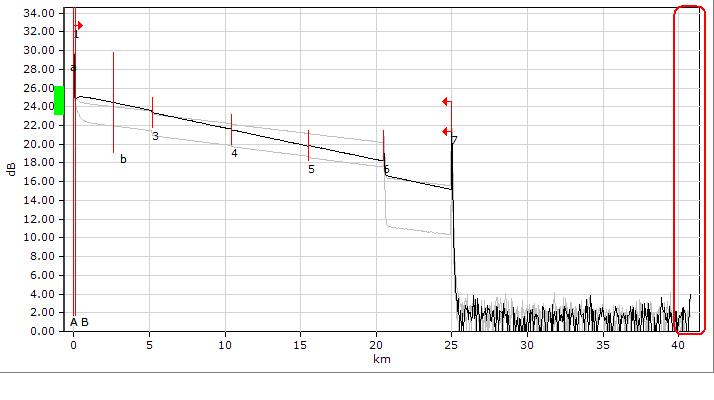

Post by Pradip » Fri Jul 10, 2009 5:51 pm
hi
please see below image

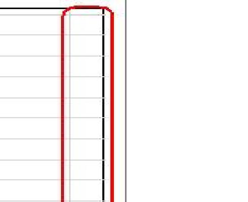

for more clear picture please see this images
the horizontal grid lines (which are gray in color) are overlapping on the axes on the right side(black in color).
in 400% zoom the lines are more cleares and it looks like the right side axis is cutting.
please give us any solution so that we can resolve this defect.
thank in advance.

Hello Pradip,
I could reproduce your problem with last versions of TeeChartFor .Net, and I have conciderated add to list bug reports with number [TF02014289], we will try to fix it for next versions of TeeChart .NET.
On the other hand, I make a simple code that solve your problem,drawing directly in the canvas a line.Please check that next code works fine in your application.
          Steema.TeeChart.Styles.Line line = new Steema.TeeChart.Styles.Line(tChart1.Chart);
          line.FillSampleValues();
          tChart1.AfterDraw += new Steema.TeeChart.PaintChartEventHandler(tChart1_AfterDraw);
          tChart1.Draw();
        void tChart1_AfterDraw(object sender, Steema.TeeChart.Drawing.Graphics3D g)
            Rectangle rect = new Rectangle();
            rect = tChart1.Chart.ChartRect;
            g.Pen.Color = tChart1.Axes.Left.AxisPen.Color;
            g.VerticalLine(rect.Right,rect.Top,rect.Bottom);
I hope that will helps.

hi Sandra,
thanks for the suggetion.
i had tried your code to resolve this problem, at first it looks ok, but if we zoom to 400 there are still small lines shows on the vertical right axes, which was not accepted at our end.
I couldn't reproduce your problem here, please you could send us a simple example project we can run "as-is", to reproduce the problem here? Now, you can attach your project direcly in forums post.
