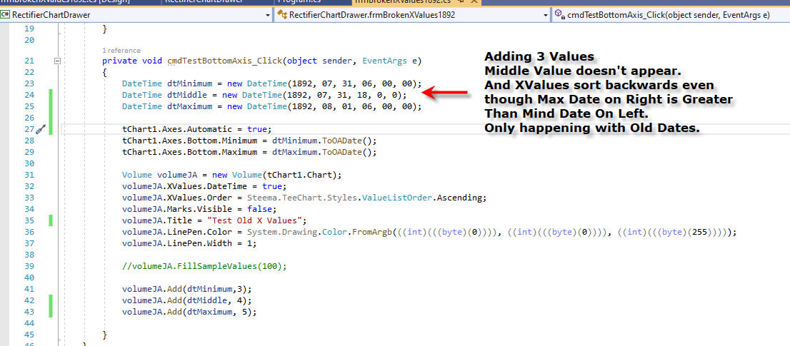

I have an app that works fine with modern dates.

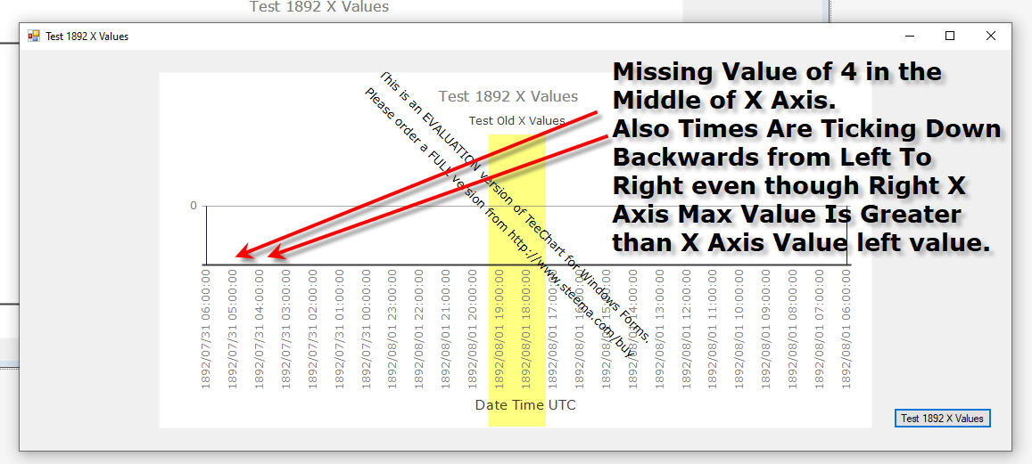

But I tried to run a chart yesterday with dates from 1892 and the Bottom (XValue) Axis doesn't show values in the middle of the XAxis.
Only values on the left and right sides of the chart show -- which is weird.
I've attached some screenshots and the sample project --
Thanks for your help.
Joseph

thank you for your report. Seems like the issue is related to Microsoft's datetime zero
more here: https://learn.microsoft.com/en-us/dotne ... ew=net-8.0
We are currently checking for a solution or an interim workaround.

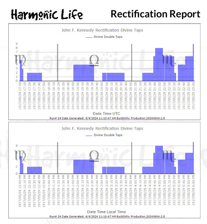

My website, HarmonicLife, figures out people's birth times given important dates in their lives -- ie Rectification.
So all of my charts are within one day.
Anyone born before 1899, ie historical figures, will run into this issue.
Julian's dates are doubles, so if I could use a double for X-Axis and then format the labels to UTC and Local Time, that would work, but I'd have to retool my reports, which will take time and testing, etc...

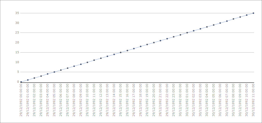

If your charts are showing one full day or less then we may have a straightforward solution, to invert the Axis.
This sample code for example:
DateTime startDate = new DateTime(1892, 12, 29, 0, 0, 0);
if (startDate.ToOADate() <= 0)
    tChart1.Axes.Bottom.Inverted = true;
for (int i = 0; i < 24; i++)
    DateTime currentDayTime = startDate.AddHours(i);
    tChart1[0].Add(currentDayTime, i);
tChart1.Axes.Bottom.Labels.DateTimeFormat = "dd/MM/yyyy HH:mm:ss";
