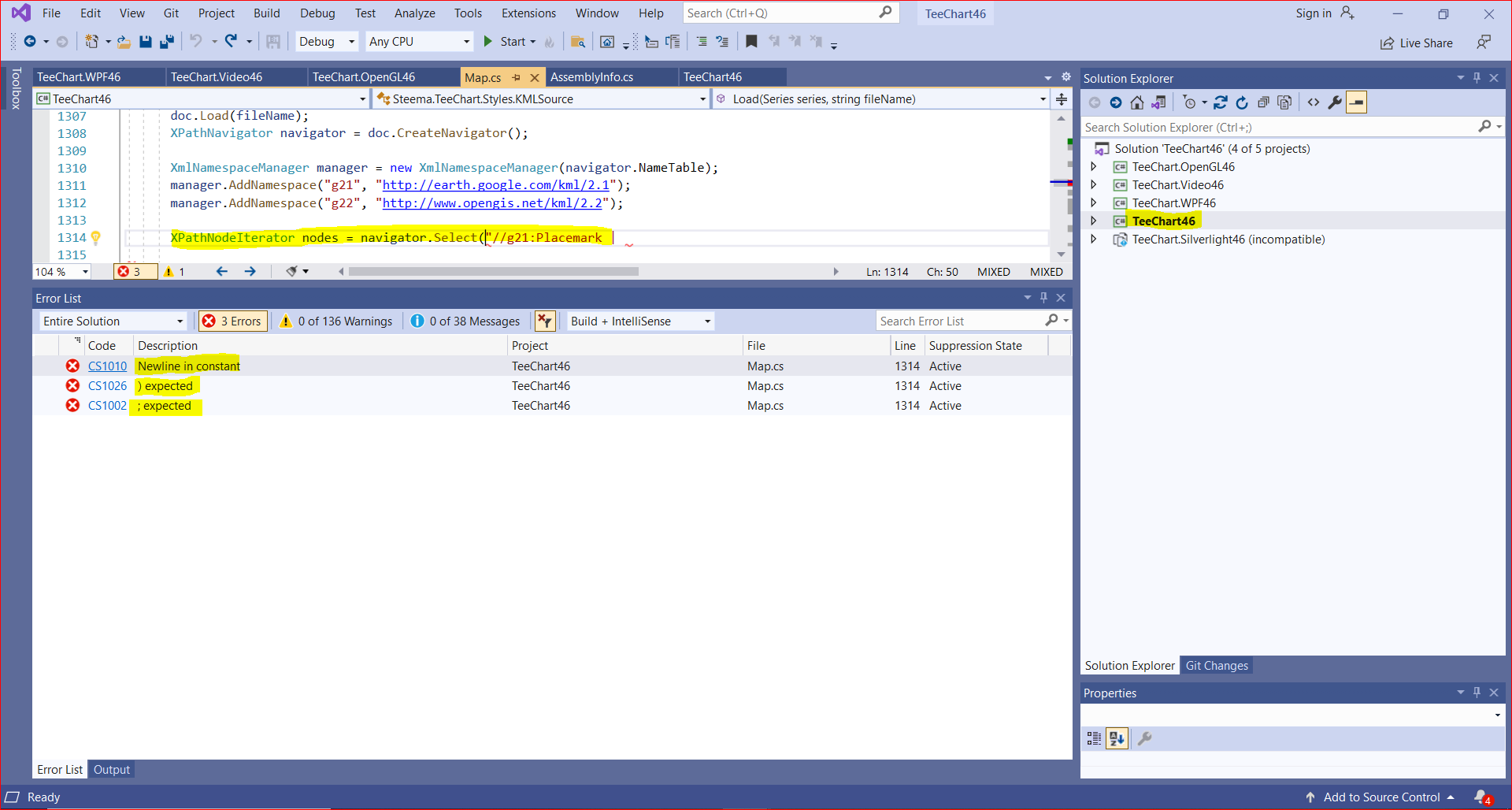

Currently, we are using TeeChartNET2015SRC_4.1.2015.12160.exe
And using this link to download it - https://www.steema.com/ma_archive
We are getting the following errors when we tried to build the library (TeeChart46) source code in x86,
Where the function navigator.Select() is not closed with the correct string and punctuation.
Please let us know the correct line or things that need to be done.
Note: We haven't touched any source code. We are facing this issue while compiling the original code (we opened this sln "TeeChart46.sln")

The missing line is:
XPathNodeIterator nodes = navigator.Select("//g21:Placemark | //g22:Placemark", manager);
