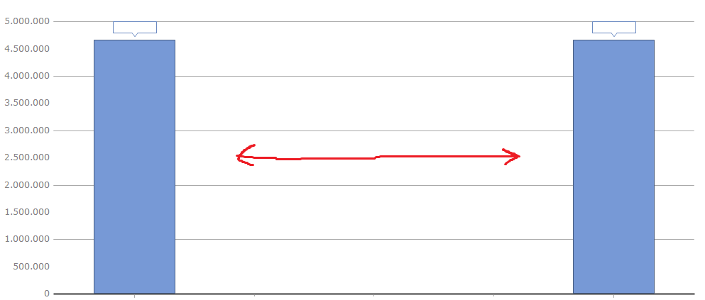

When i plot two bars the separation between them is a bit too much, what could i do to shorten this distance?
How could o control the space between bars independently of how many there are?
Thank you.
Re: Space/Separation between bars with TeeChart for .Net
Post by Christopher » Thu Jun 22, 2023 4:21 pm
David N. wrote:
Thu Jun 22, 2023 8:46 am
This can be achieved by compressing the bottom axis with offset pixels, e.g.
            bar.Add(1);
            bar.Add(10);
            tChart1.Axes.Bottom.MinimumOffset = 170;
            tChart1.Axes.Bottom.MaximumOffset = 170;
