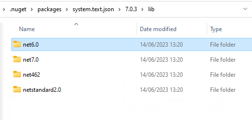

System.Text.Json v7.0.3. is built for net6.0, as you can see both in the nuget package itself:
Screenshot from 2023-06-19 16-19-52.png (16.82 KiB) Viewed 39818 times
And in the documentation on its NuGet page:
Screenshot from 2023-06-19 16-22-02.png (93.38 KiB) Viewed 39818 times
I cannot see any technical reason for believing that this NuGet is incompatible with net6.0, or that it was designed exclusively for use in net7.0
