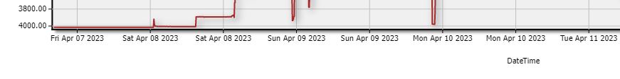

I having date format issues
it should be 00:00:00 07-Apr-2023
     this.TChart.axes.bottom.visible = true;
      this.TChart.axes.bottom.labels.dateFormat = "HH:mm:ss dd-MMM-yy";
      this.TChart.axes.bottom.title.text = "\nDateTime";
      this.TChart.axes.bottom.grid.visible = true;
      this.TChart.axes.bottom.automatic = true;

I've added an option in the combo here, custom3:
https://www.steema.com/files/public/tee ... tetime.htm
code:
Chart1.axes.bottom.labels.dateFormat = "hh:mm:ss d-mmm-yy";
