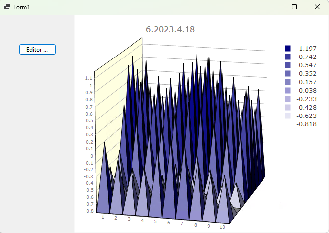

please note that there are now two versions of TeeChart and therefore two different NuGet packages:
1. TeeChart.NET Pro Edition
2. TeeChart Business Edition
The Pro edition has the Tower Series in it:
            tChart1.Aspect.View3D = true;
            tChart1.Aspect.Chart3DPercent = 100;
            tChart1.Aspect.Zoom = 80;
            tChart1.Header.Text = Steema.TeeChart.Utils.Version;
            var tower = new Steema.TeeChart.Styles.Tower(tChart1.Chart);
            tower.FillSampleValues();
            tower.TowerStyle = Steema.TeeChart.Styles.TowerStyles.Pyramid;
Screenshot from 2023-04-24 10-47-58.png (154.92 KiB) Viewed 6384 times
