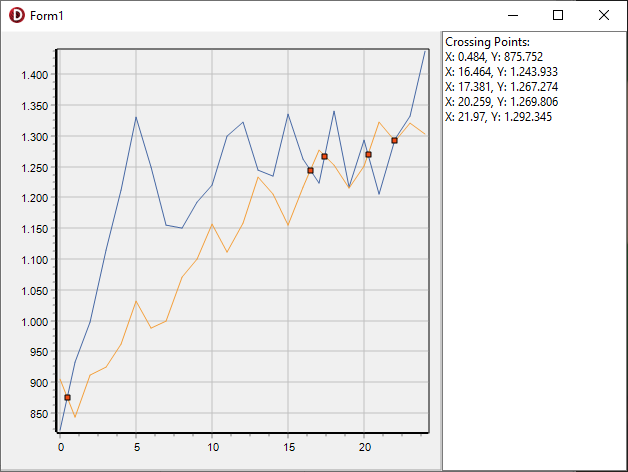

series 1 and series2 is crossing .. but how do I get the value of the cross point

Post by Yeray » Mon Mar 06, 2023 10:57 am
Yes, the series you assign the TCrossPointsFunction to contains the crossing points.
Ie:
uses Vcl.StdCtrls, VCLTee.TeeGDIPlus, VCLTee.Chart, VCLTee.Series, VCLTee.StatChar;
var Chart1: TChart;
    line1, line2: TLineSeries;
    crossFunction: TCrossPointsFunction;
    crossPoints: TPointSeries;
    Memo1: TMemo;
var i: Integer;
  Chart1:=TChart.Create(Self);
  Chart1.Parent:=Self;
  Chart1.Align:=alClient;
  Chart1.View3D:=False;
  Chart1.Legend.Hide;
  Memo1:=TMemo.Create(Self);
  Memo1.Parent:=Self;
  Memo1.Align:=alRight;
  line1:=TLineSeries(Chart1.AddSeries(TLineSeries));
  line2:=TLineSeries(Chart1.AddSeries(TLineSeries));
  line1.FillSampleValues;
  line2.FillSampleValues;
  crossFunction:=TCrossPointsFunction.Create(Self);
  crossPoints:=TPointSeries(Chart1.AddSeries(TPointSeries));
  crossPoints.Pointer.Size:=2;
  crossPoints.FunctionType:=crossFunction;
  crossPoints.DataSources.Add(line1);
  crossPoints.DataSources.Add(line2);
  Memo1.Lines.Add('Crossing Points:');
  with crossPoints do
    for i:=0 to Count-1 do
      Memo1.Lines.Add('X: '+FormatFloat(ValueFormat, XValues[i])+', Y: '+FormatFloat(ValueFormat, YValues[i]));
