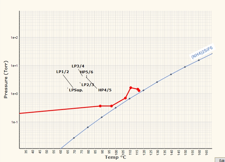

I'm using a chart with a serie Line, and adding some marks on it, label style. I tried to locate the marks in "auto" but at the end, some marks is always over the line.
Is there any way to locate the marks on some area where there is no curve ?
See "LP2/3" and "HP5/6" marks below, they could be under the point, but I don't know how to do it.
The free component Microsoft Graph was doing this, with automatic callouts with well separated marks from the points if they were too close.

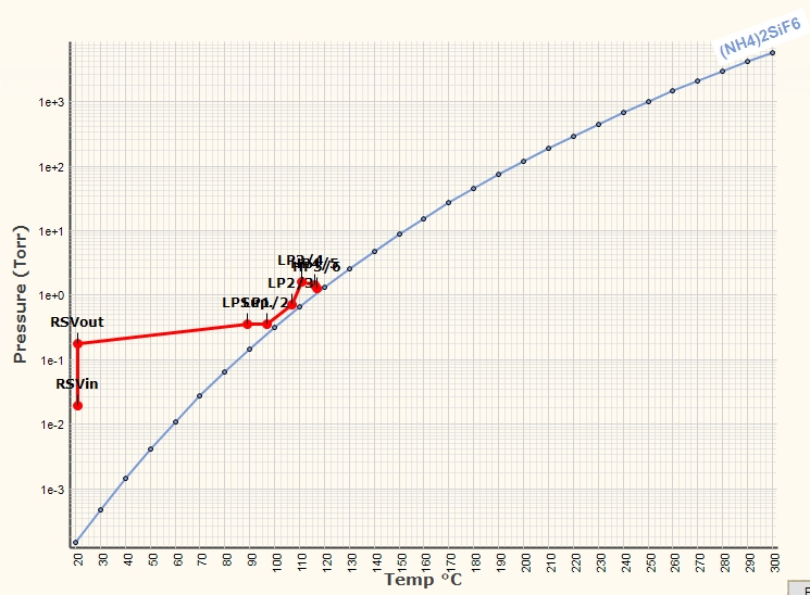

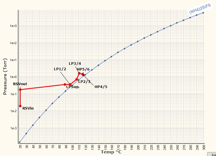

Now the problems I still have are the following :
- the repositionning works, but to see it i must click on the graph. It won't update the graph before I "touch it"
- after zooming on a specific area, the initial marks remain at their location, and are not displayed with the new view after zoom.
(attached 3 pictures, after alignment, after marks alignment, and after zoom)
I guess this is something very simple I miss, but I don't see....
