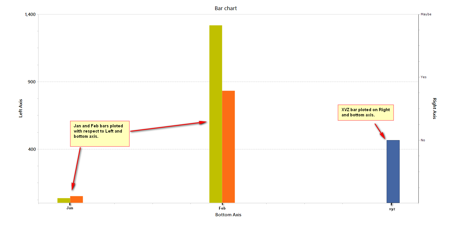

We have used TChart.Net 2012 and created a bar chat. In which we have plotted multiple bar series on left and bottom axis. Now we want to add some bar series on Right and bottom axis.
When we created this chart then the xyz bar snugly with "Jan" label.
If we set the MultiBars Styles as "SideAll" then all bars are displayed separately.
So we want to display the chart as same as attached image.

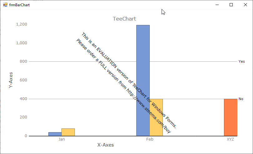

yes, this is possible - I've attached a retouched project, which here gives me:

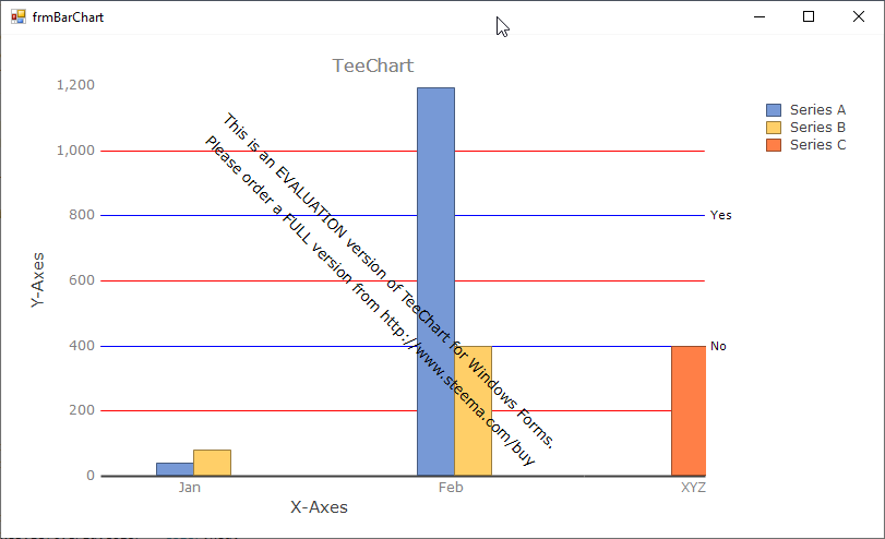

I have run your code and found that that in demo, axis line of left and right axis and legend are not visible.

Commenting out some existing code and adding in a couple more lines gives me the following:
            ArrangeBottomAxes(m_bar2);
            //m_bar2.MultiBar = Steema.TeeChart.Styles.MultiBars.SideAll;
            //tChart1.Legend.Visible = true;
            //tChart1.Aspect.View3D = false;
            //tChart1.Legend.CustomPosition = true;
            //tChart1.Legend.LegendStyle = LegendStyles.Series;
            //tChart1.Legend.Shadow.Visible = false;
            //tChart1.Legend.Transparency = 100;
            //tChart1.Legend.Top = 100;
            //tChart1.Legend.Left = 900;
            tChart1.Axes.Bottom.Title.Text = "X-Axes";
            tChart1.Axes.Left.Title.Text = "Y-Axes";
            //tChart1.Axes.Right.Title.Text = m_Points3.Title;// Right-Axes title
            tChart1.Axes.Left.Grid.Visible = true;
            tChart1.Axes.Left.Grid.Color = Color.Red;
            tChart1.Axes.Left.Grid.DrawEvery = 1;
            tChart1.Axes.Right.Grid.Visible = true;
            tChart1.Axes.Right.Grid.Color = Color.Blue;
            tChart1.Axes.Right.Grid.DrawEvery = 1;
Amol

We have got your code but in chart the vertical Axis line, in which ticks and labels are showing, are missing. Only the grid lines are displayed on chart.
But we want to display the vertical axes lines(i.e. Y-Axis and Alternate Y axis) on chart.
