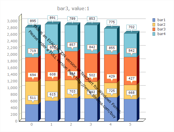

Your sample don't need any modification - at also have the same bug:
It still showing bar2, value:5 when cursor is already above bar3 (cyan). I need to move cursor higher to change it to bar3, value:5.
That is because component thinks that cursor is above top face of bar2 (orange) and ignores the fact that bar3 (cyan) hides that top face.

One of my colleages has a suggestion which seems to resolve the issue; if you reverse the order of the series when searching for the click, the problem doesn't seem to occur, e.g.
