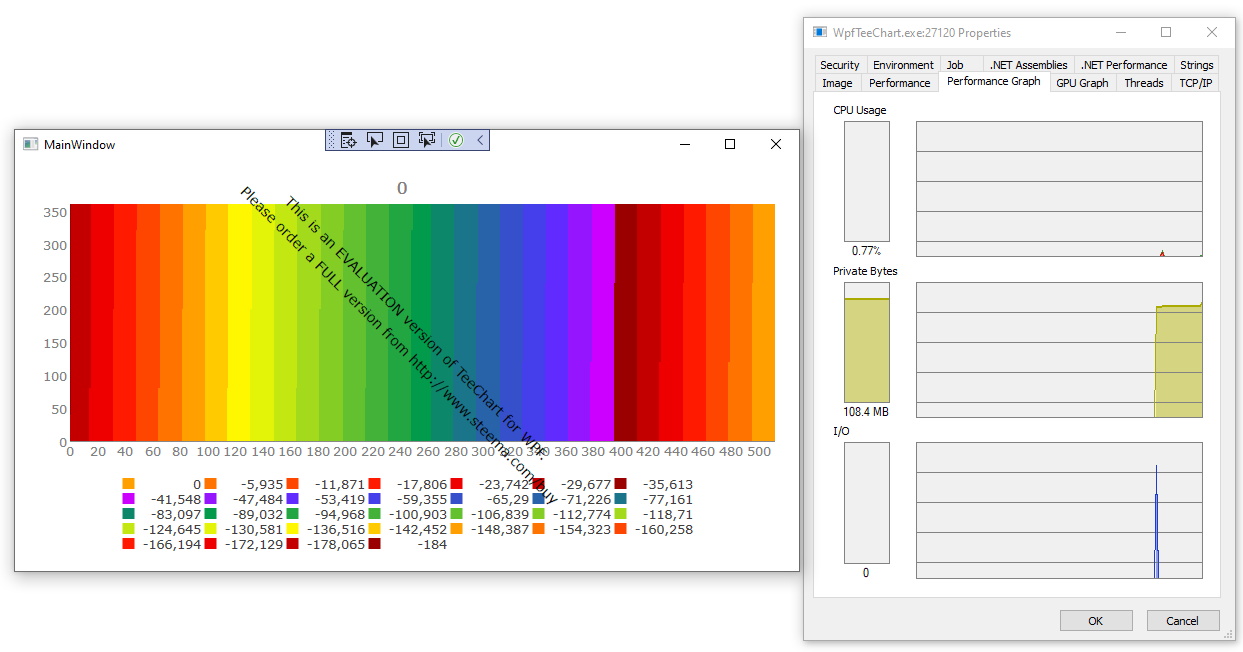

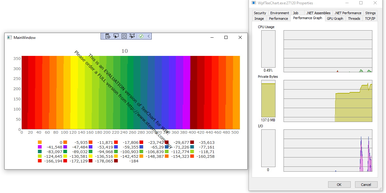

After each click the memory usage will grow. It will fall down after a few clicks but not to the starting point.
In the sample we use the ColorGrid.

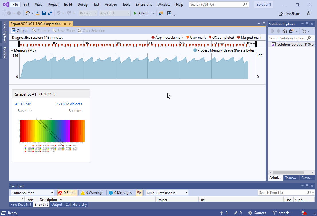

I then ran this code in a Memory Usage diagnostic session as detailed here using the latest publicly available version of Visual Studio 2019. I've uploaded the results here in the form of a *.diagsession file which you can open in Visual Studio 2019. The results look like this:
As you can see, this specific diagnostic session has failed to detect any kind of memory leak in the code.
