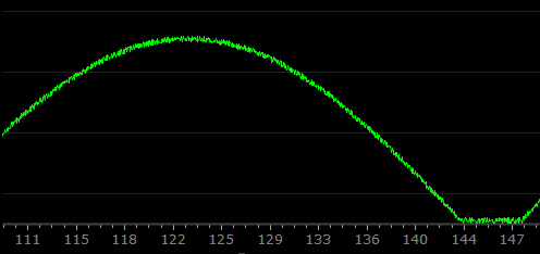

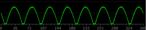

I have a fast line chart that is representing an Oscilloscope. The Bottom axis maximum points vary continuously so I am resetting that value repeatedly. My problem comes in that if I have zoomed in on the graph, the x-axis zooms back out as soon as I change the maximum value and the zoom is lost. How do I get it to "Stick" Thanks.
This is before zoom
This is after zoom
As soon as I run this:
chart.Axes.Bottom.Minimum = 0
chart.Axes.Bottom.Maximum = CurrMaxPoints
It zooms back out. I want it to stay focused on the same area of the graph.

The 0-360 are just the labels and the actual points are 0 to anywhere from 5k-30k points. Since that high end changes every second or so I need to keep it up to date to show accurately.
I was able to find a simple suitable workaround where I do not change the bottom axis points when it is zoomed. If zoom cleared they get updated.
