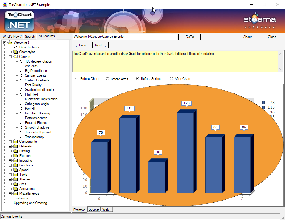

You're best bet would be to use the Canvas Events - the following is a screenshot from the Feature Demo on GitHub:
You can use these canvas events to draw anything to the chart - lines, shapes (circles, rectangles) - basically anything TeeChart can draw. To draw something at a specific series value, you can use something like this:

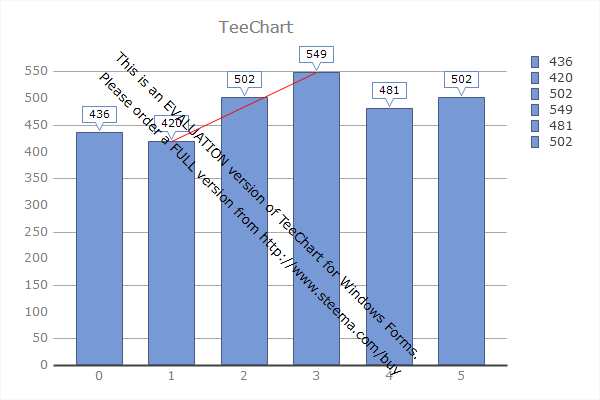

                g.Pen.Color = Color.Red;
                g.Line(minPoint, maxPoint);
Which here gives me:
