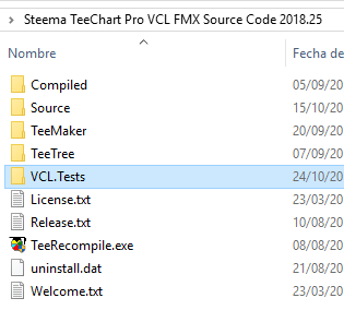

Sorry, but same problem. I uninstalled all prior installations to start fresh and then did the 2018.25 install. At completion I added the VCL.Tests folder as shown in your example. See screen shot:

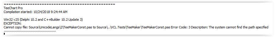

Then I double-clicked on the TeeRecompile program and at completion I received the same error message:

Suggestions?
Re: Win32 v14 (Delphi and C++Builder 2010 Update 5 (Database Pack)) (2010 Update 4) ERROR
Post by Yeray » Wed Oct 24, 2018 1:38 pm
Please, create a "TeeMaker" folder inside the "VCL.Tests" folder you just created.

ok, that solved the problem! Many thanks.
