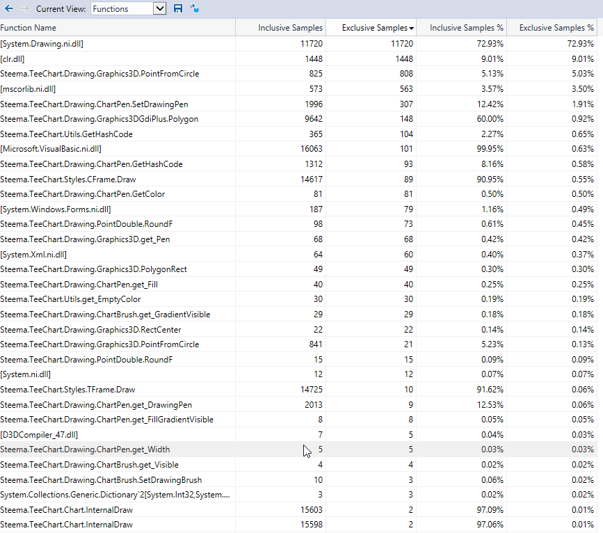

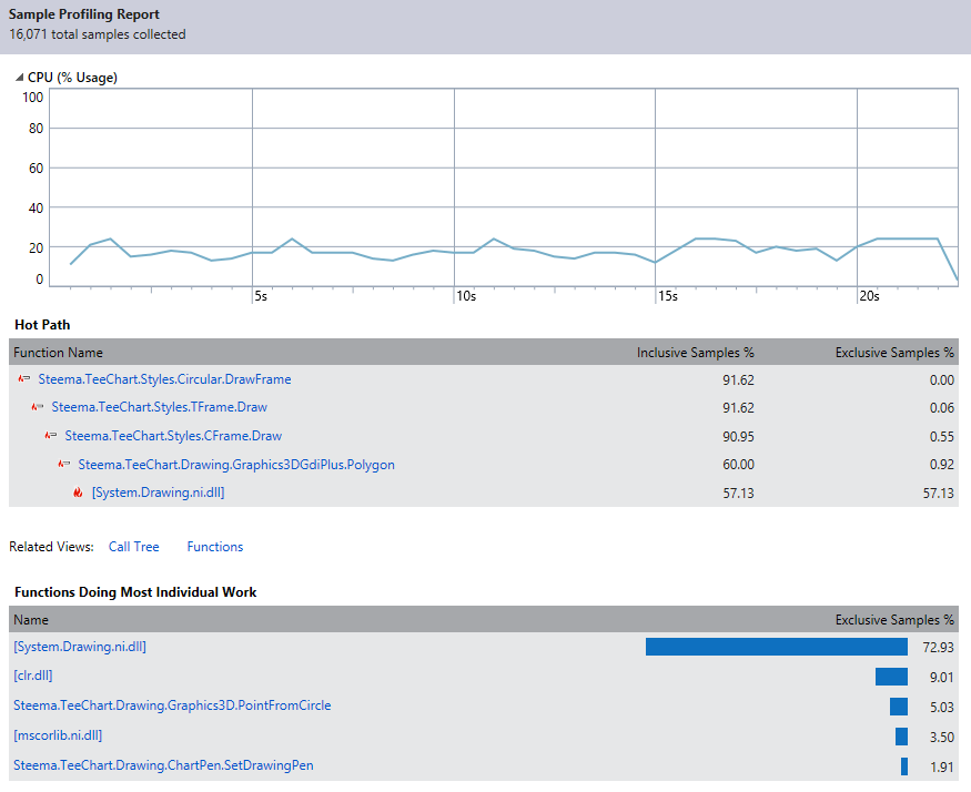

thank you for your example project. I have run this project and profiled the TeeChart.dll, the Windows Forms component, with these results:
looking more carefully at the functions I see this:
I see these results as expected. What these results state is that nearly three-quarters of the time needed for TeeChart to render is used by System.Drawing.dll, a .NET Framework assembly. Just over a quarter of the time needed to render TeeChart is used by functions written by Steema within the TeeChart code. This is expected because TeeChart is a visual component and as such is completely dependent on the bitmap rendering algorithms of the .NET Framework.

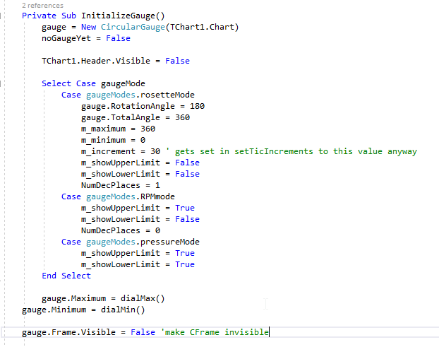

Basically, then, the less that is drawn onto the TeeChart the quicker it will render. One example of this is the CFrame you mention, which can be made invisible (and hence not drawn) with code such as the following:
the results of which look like this:

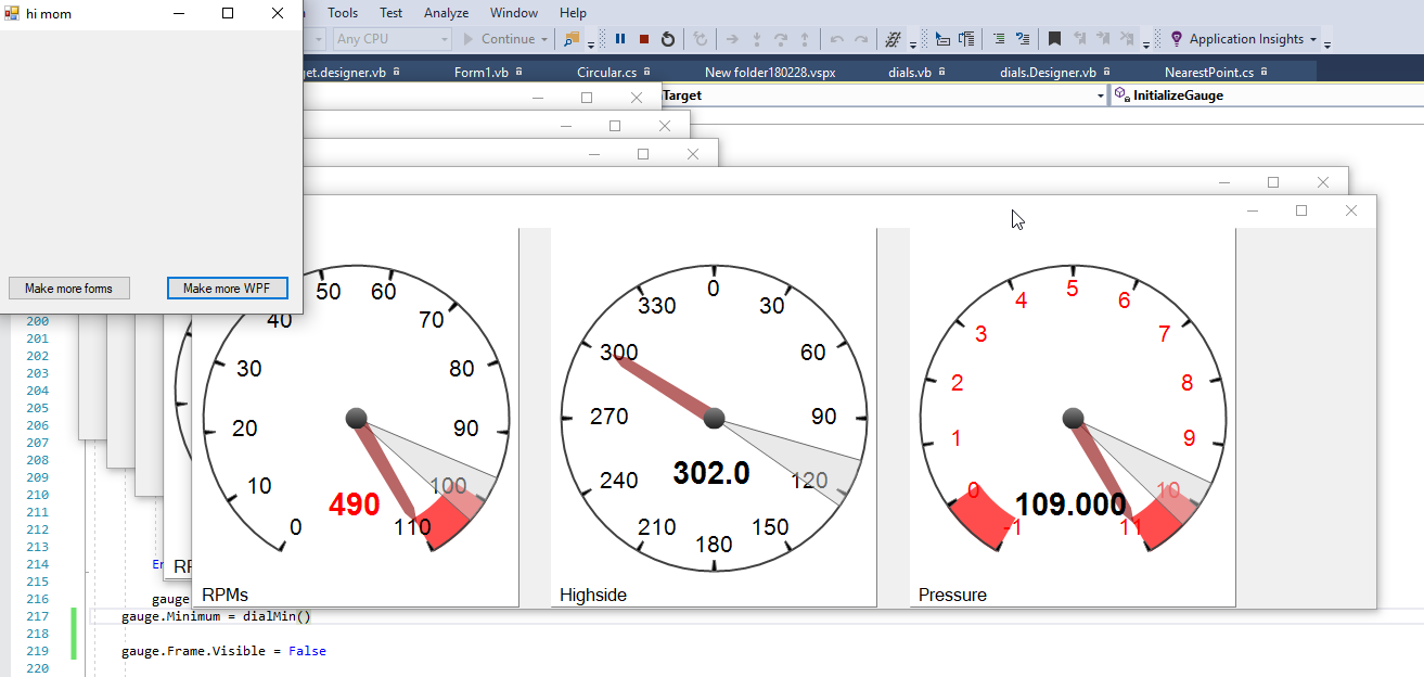

Well, in theory the .NET WPF is rendering using DirectX, no? And this is, in fact, born out by that project. If you close the Forms window and open several more WPF windows and then do the performance profiling again you will see radically different results. The WPF forms render much faster.
Still, the performance on all of them is really quite bad. I fully expect my customers to have 8-12 dials open at any given time. The performance issue renders the dials quite useless - these are real-time measures of processes and if the dial isn't updating then they do not know what they're doing.
As for the CPU graph in re: performance.... Mine shows that, too. However, that's as a percentage of total CPU on the computer. One core is railed. Given that graphics can only be done on one core this makes sense.
Edit: So... Do you have any other suggestions on performance? Taking the frame away makes things incredibly fast but visually things are a bit, um. How can I still have a full circle every time?

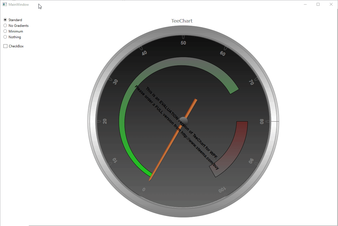

I've created a little WPF project for you showing the effect of drawing ever less elements onto the Chart:
http://teechart.net/files/public/suppor ... ProWPF.zip
here, in Release mode, the project runs like this:
Again, I see this performance as expected - the fewer the elements, and the lesser the rendering complexity of each element (e.g. Gradient etc.), the quicker the chart paints. Please bear in mind that in WPF the frames per second is not an accurate reflection of the number of bitmaps the WPF framework renders to the screen - we calculate the FPS by the number of parses made through the TeeChart drawing code, but as WPF uses a retained mode graphics system then this is not an accurate reflected of the actual framerate.
