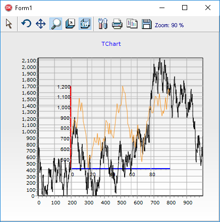

According reference http://www.teechart.net/docs/TeeChartVCLReference.htm, Grid zoning (defined with UsePartnerAxis, PartnerAxis) permits the pairing of Axes so that Gridlines plotted from either Axis are delimited by the zone of the partner. But at least in version 2017.21.170329, when 2 custom axes are used, the grid lines are through the whole chart. see:

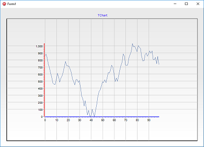

Post by Yeray » Wed Oct 18, 2017 7:25 am
What TeeChart version are you using?
This is what I get with your code in TeeChart Pro v2017.22:
I only added this to your code:
  Chart1.View3D:=False;
  Chart1.Legend.Visible:=False;

hello Yeray,
Thank you for the quick answer. As I mentioned in my post, version 2017.21 is used, but from your post I understand that the problem persists also in 2017.22 in 3DView mode.
Chart1.View3D:= FALSE sorts the problem until we put TTeeCommander.
As soon as drag/zoom buttons of TTeeCommander are used - the chart switches to 3DView mode and the grid is not clipped anymore. Some time ago I found a suggested solution for this problem to keep the chart in 3DView mode with 1% (may be by you).
In my opinion, there are several issues that should be fixed at some point (better sooner than later):
- TTeeCommander should not change 3DView mode to TRUE after drag or zoom.
- CustomAxis with PartnerAxis set should clip the grid lines even in 3DView.
- It should be possible to set that a CustomAxis reacts on Zoom event or ignores it (off current topic, but just to mention it).
PartnerAxis was introduced in 2010, as I could read. I cannot understand how nobody reported the problem.

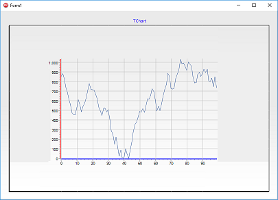

That's right. It works as you wish for 2D only, also with the default axes:
uses Series;
var ser: TFastLineSeries;
  with Chart1.Axes.Bottom do
    StartPosition:= 20.0;
    EndPosition:= 80.0;
    PositionPercent:= 20;
    Axis.Color:= clBlue;
    UsePartnerAxis:=True;
    PartnerAxis:=Chart1.Axes.Left;
  with Chart1.Axes.Left do
    EndPosition:= 80.0;
    Axis.Color:= clRed;
    PartnerAxis:=Chart1.Axes.Bottom;
  end;;
  ser:= TFastLineSeries.Create(Chart1);
  chart1.AddSeries(ser);
  ser.FillSampleValues(100);
