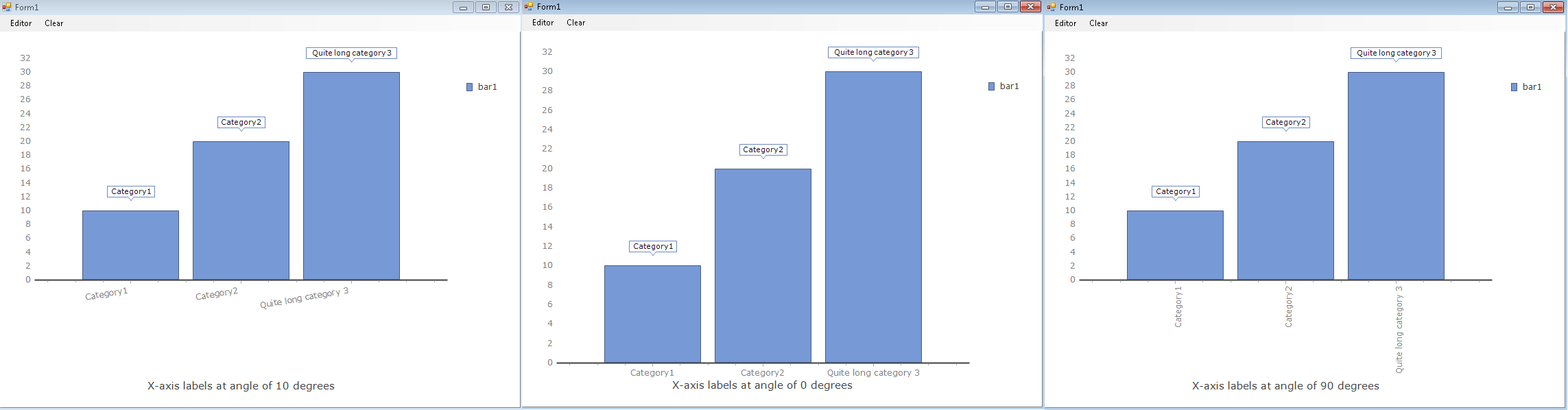

When creating a chart where the bottom axis labels are rotated between 1 and 89 degrees, the chart area is only as high as it would be when the labels are rotated 90 degrees.
This means that there can be quite some unnecessary whitespace between the bottom axis title and the bottom axis labels.
I have added some screenshots of the behavior and a code snippet below to reproduce the behavior.
Is this behavior considered a bug, and are there some easy work-arounds to automatically avoid the unnecessary whitespace?

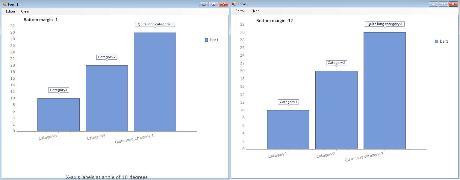

The behaviour isn't considered a bug as with movement of the label angle constant changing of the axis position, might be considered as undesirable. Perhaps we could add a boolean to activate/deactivate auto-spacing.
You can control the space by adjusting the bottom margin. You can find the property in the editor under Panel:Margins or via this coded property:
tChart1.Panel.MarginBottom = 0 (can use negative figures by code);

Unfortunately, the suggested work-around by adjusting the bottom margin causes the bottom axis title to be cut (as can be seen in the screenshots below), so this work-around cannot be used.

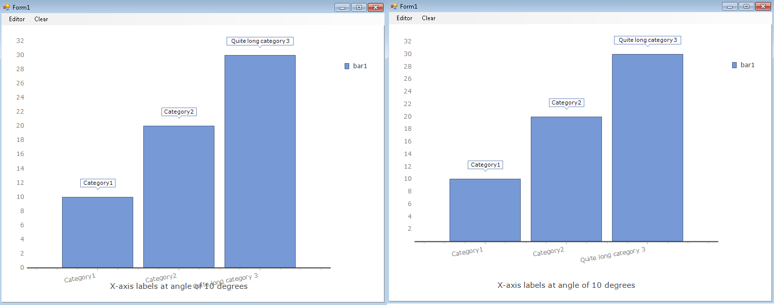

In researching possible solutions a bit further, I stumbled upon the AxisLabels:CustomSize property, which I can use in code to influence the space that is taken by the bottom axis labels:
tChart1.Chart.Axes.Bottom.Labels.CustomSize = 20;
With this property, it seems that I can avoid the unnecessary whitespace if the custom size is chosen well (see screenshots below).
To correctly indicate this custom size, it seems however that I need to know the height of the largest rotated axis label.
Do you have any idea whether and how it is possible to calculate this?

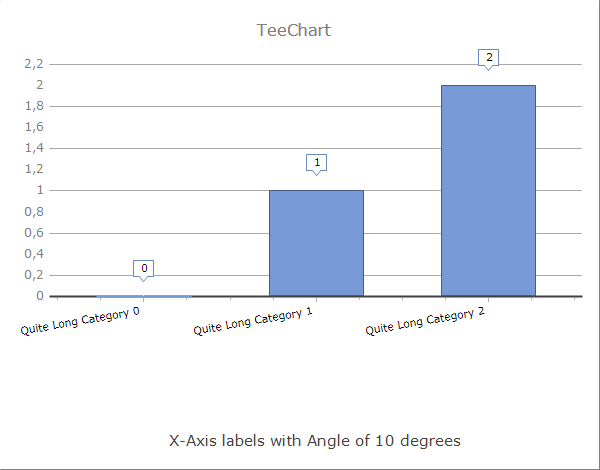

I think custom labels can handle this better - the following code:
    Bar series;
      series = new Bar(tChart1.Chart);
      for (int i = 0; i < 3; i++)
        series.Add(i); //, "Quite Long Category " + i.ToString());
        tChart1.Axes.Bottom.Labels.Items.Add(i, "Quite Long Category " + i.ToString());
      int degrees = 10;
      tChart1.Axes.Bottom.Labels.Angle = degrees;
      tChart1.Axes.Bottom.Title.Text = $"X-Axis labels with Angle of {degrees} degrees";
produces the following chart for me here:

I'm afraid though, it doesn't help with the issue I'm facing. As you can see in your own screenshot, there is still a large blank area between the axis labels and the axis title, even when using custom labels.
Possibly it is easier to calculate the height of the labels when using custom labels, so I can use it in combination with the CustomSize property?

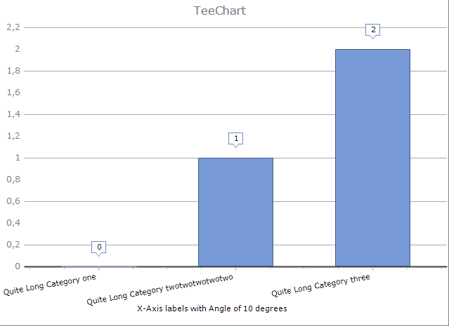

for pixel precise positioning of text under the bottom axis's labels when these are rotated you could consider using code similar to the following:
    Bar series;
    int degrees, height;
    AxisLabelItem longestLabel;
    string title;
      string[] extra = new string[] { "one", "twotwotwotwotwo", "three"};
      int longestString = 0;
        string text = "Quite Long Category " + extra[i];
        int length = text.Count();
        series.Add(i);
        tChart1.Axes.Bottom.Labels.Items.Add(i, text);
        if (length > longestString)
          longestString = length;
          longestLabel = tChart1.Axes.Bottom.Labels.Items[i];
      degrees = 10;
      title = $"X-Axis labels with Angle of {degrees} degrees";
      tChart1.BeforeDrawSeries += TChart1_BeforeDrawSeries;
      Bitmap bmp = tChart1.Bitmap;
    private void TChart1_BeforeDrawSeries(object sender, Graphics3D g)
      Func<AxisLabelItem, int, int> CalcRotatedHeight = (label, angle) =>
        Matrix m = g.GDIplusCanvas.Transform;
        m.RotateAt((float)(360 - angle), new Point(label.Left, label.Top));
        g.GDIplusCanvas.MultiplyTransform(m);
        Point[] shapePolygonBounds = new Point[] { new Point(label.ShapeBounds.Left, label.ShapeBounds.Top), new Point(label.ShapeBounds.Right, label.ShapeBounds.Top),
                new Point(label.ShapeBounds.Right, label.ShapeBounds.Bottom), new Point(label.ShapeBounds.Left, label.ShapeBounds.Bottom), new Point(label.ShapeBounds.Left, label.ShapeBounds.Top)};
        m.TransformPoints(shapePolygonBounds);
        g.GDIplusCanvas.ResetTransform();
        return g.PolygonBounds(shapePolygonBounds).Height;
      height = CalcRotatedHeight(longestLabel, degrees);
      int middle = (tChart1.Axes.Bottom.IEndPos - tChart1.Axes.Bottom.IStartPos) / 2;
      int width = Utils.Round(g.TextWidth(title));
      g.TextOut(middle - (width / 2), tChart1.Axes.Left.IEndPos + height, title);
      tChart1.Panel.MarginUnits = PanelMarginUnits.Pixels;
      tChart1.Panel.MarginBottom = (height - width) + 20; //20 pixels between text and bottom of chart
which gives me:
I will look into the possibility of incorporating this technique (or similar) to ensure precise axis title positioning with rotated labels.
