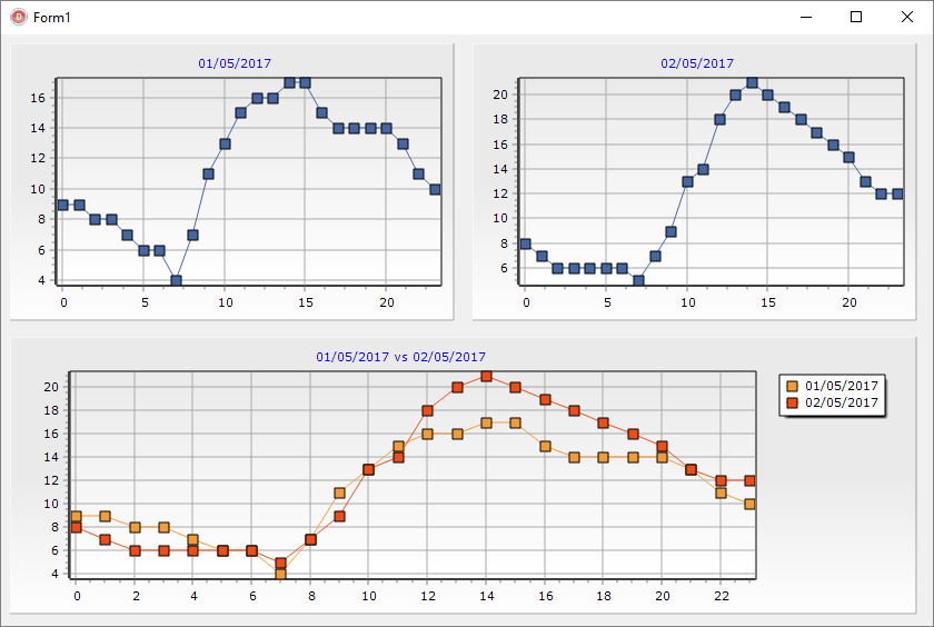

Ie, here I use 3 charts. The first two are to generate the tee files, the third is the destination chart I use to load the two tee files into:

  //Load Charts
  RegisterTeeStandardSeries;
  oldX:=Chart3.Left;
  oldY:=Chart3.Top;
  oldW:=Chart3.Width;
  oldH:=Chart3.Height;
  LoadChartFromFile(Chart3, fileName1);
  Chart3.Left:=oldX;
  Chart3.Top:=oldY;
  Chart3.Width:=oldW;
  Chart3.Height:=oldH;
  tmpChart:=TChart.Create(Self);
  LoadChartFromFile(tmpChart, fileName2);
  CloneChartSeries(tmpChart[0], Chart3);
  Chart3[0].Title:=Chart3.Title.Text.Text;
  Chart3[1].Title:=tmpChart.Title.Text.Text;
  Chart3.Legend.Visible:=True;
  Chart3.Title.Text[0]:=Chart3.Title.Text[0] + ' vs ' + tmpChart.Title.Text[0];
  Chart3[0].Color:=OperaPalette[1];
  Chart3[1].Color:=OperaPalette[2];
  FreeAndNil(tmpChart);

  //Load Charts
  RegisterTeeStandardSeries();
  int oldX=Chart3->Left;
  int oldY=Chart3->Top;
  int oldW=Chart3->Width;
  int oldH=Chart3->Height;
  Chart3->Left=oldX;
  Chart3->Top=oldY;
  Chart3->Width=oldW;
  Chart3->Height=oldH;
  TChart *tmpChart = new TChart(this);
  Chart3->AddSeries(CloneChartSeries(tmpChart->SeriesList->Items[0]));
  Chart3->SeriesList->Items[0]->Title=Chart3->Title->Text->Text;
  Chart3->SeriesList->Items[1]->Title=tmpChart->Title->Text->Text;
  Chart3->Legend->Visible=True;
  Chart3->Title->Text->Text=Chart3->Title->Text->operator [](0) + " vs " + tmpChart->Title->Text->operator [](0);
  Chart3->SeriesList->Items[0]->Color=OperaPalette[1];
  Chart3->SeriesList->Items[1]->Color=OperaPalette[2];
