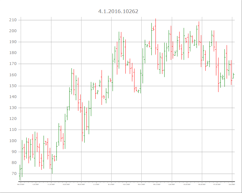

Figure 1: Using the TeeChart theme gives me this screen. A uneven spacing of vertical grid lines. Note that I had to set the ChartAxis.Grid.DrawEvery = 1; in ThemeProperties.ChangeAxis(Axis ChartAxis) for bottom axis because for some reason it is set to 2 and what it does is skip 1 line which is not what we want.

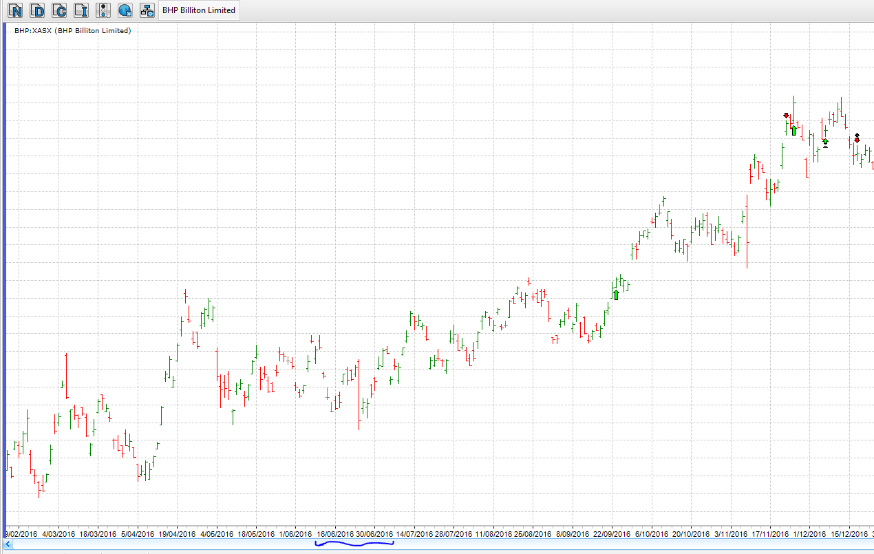

Figure 2: It seems that commenting this code ThemeProperties.Instance.AxisLabelsFontSize = 8; from TeeChartThemes.SetDefaultValues() fixes the problem but the spacing is too wide compared to what we currently have.

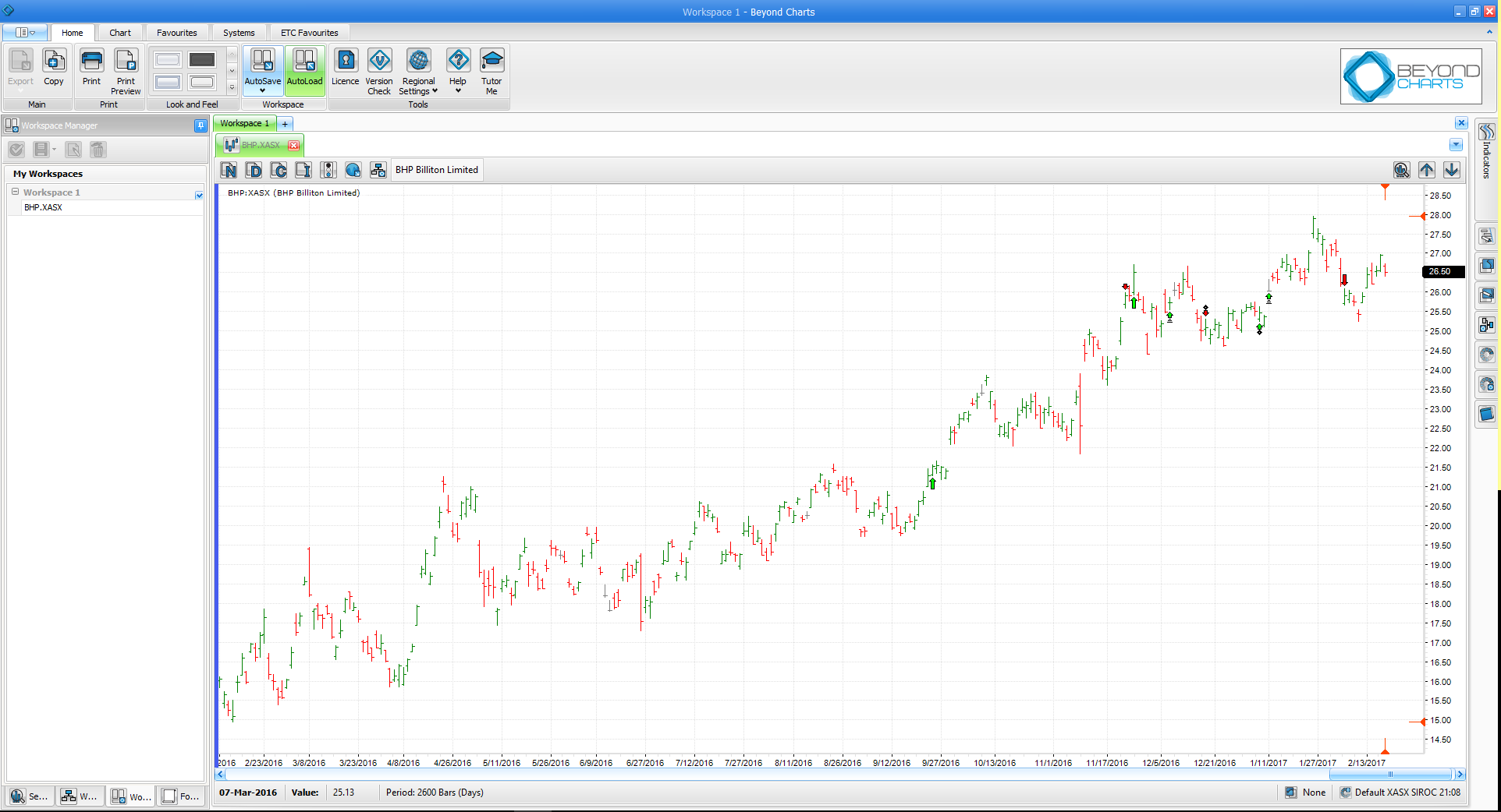

Figure 3: Is what our current app looks like with the old version of TeeChart.

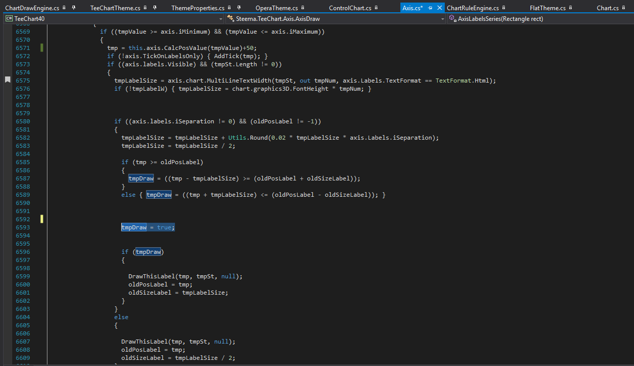

After a digging through the code, I noticed that there is a logic that skips a line when the label is too wide which I think is there to avoid overlapping dates. I found it in Axes.AxisLabelsSeries(Rectangle rect)
where tmpDraw will be false if it thinks the date will overlap. I fixed this to always true and I got the result that I needed except that its a bit cramped..
This is the code where I force tmpDraw = true

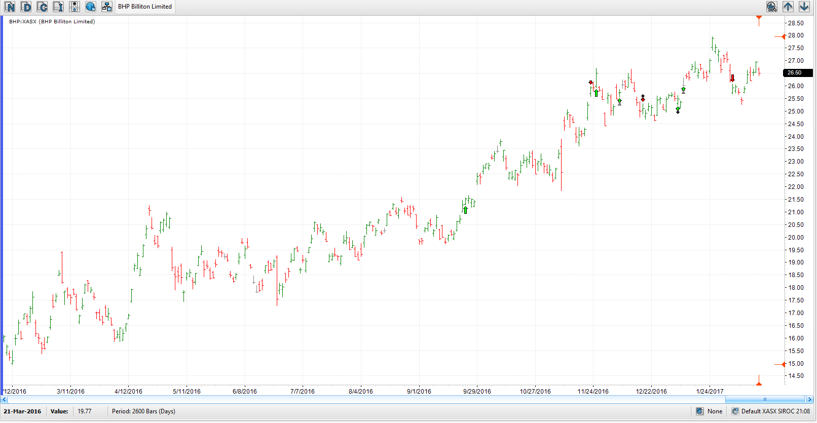

And this is what I got
Figure 2
Next question is, how to I set the width of the grid to make it a few pixels wider so the date text wont be too close to each other?
