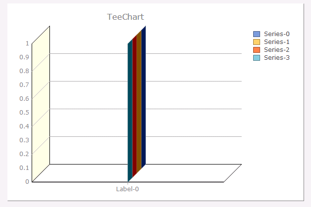

I have a problem with bars in multiple series bar charts where each series has only one point in them.

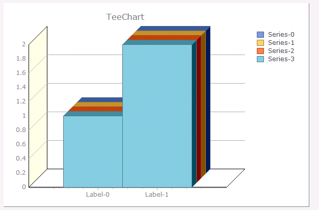

If NUMBER_OF_POINTS is set to 2 then you get:
If NUMBER_OF_POINTS is set to 1 then you get:

Unfortunately a similar issue has already been reported and fixed in id=1794. In the meantime, you should be able to set the CustomBarWidth to ameliorate the rendering in these particular cases:
