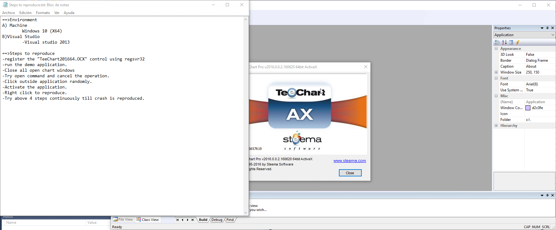

Post by SNPSUSER » Thu Feb 16, 2017 5:26 am
We have developed a sample application to demonstrate the crash in STEEMA charting control.
The application has been developed in Visual Studio 2013 and run on a windows 10 machine.
The below listed files have been uploaded to STEEMA server (under SNPSUSER user):
a) Source Code for a demo application (ZIP file)
b) Screen Recording (ZIP file)
c) Steps to reproduce (TXT file)
Please help investigate and fix the crash ASAP.
Awaiting your response, Thanks in advance.
Re: Crash on Unload
Post by Yeray » Fri Feb 17, 2017 8:59 am
I haven't been able to reproduce the problem.
I've added a call to m_ctrlChart.AboutBox() to show the TeeChart version registered / in use.
