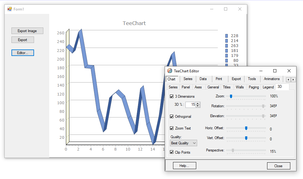

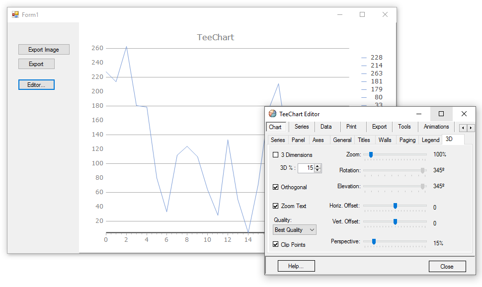

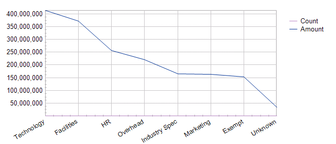

I start with a chart created with multiple Line series. The chart looks like:
if I turn on the 3D setting I get:

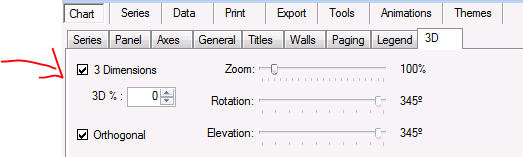

The easiest way to duplicate this is to click the 3 Dimensions check box if tools is open:
What I click.PNG (8.25 KiB) Viewed 9323 times

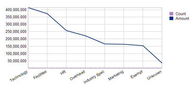

1) I want the boxes when 3D is turned off. The Legend lines in 2D mode are just too small for the user to sometimes tell the differences in the color. I have tried to change the Legend symbol and other things but nothing seems to work.
2) Why cannot I have the lines which are in 2D mode when 3D is turned on? The lines in 3D mode are really thick.
3) How do I get the "thick" lines in 2d mode?

This is what I get with this code:
			tChart1.ShowEditor();
			Line series = new Line(tChart1.Chart);
			series.FillSampleValues();
firstly:
then having activated 3D:
do you get the same with this code? If so, could you please modify it so I can reproduce your issue here?

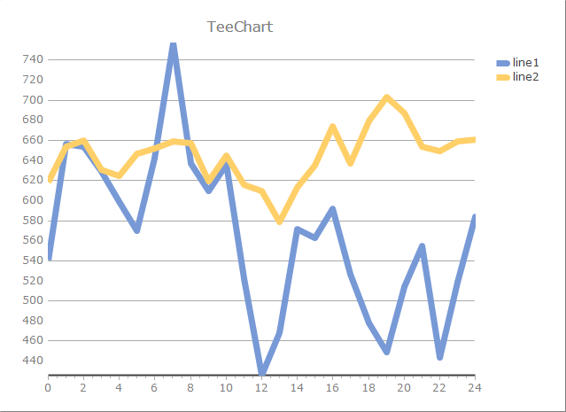

biqpaulson wrote: 3) How do I get the "thick" lines in 2d mode?
The closest might be something like this:
			Line series1 = new Line(tChart1.Chart);
			series1.FillSampleValues();
			series.LinePen.Width = 7;
			series.LinePen.EndCap = System.Drawing.Drawing2D.LineCap.Round;
			series1.LinePen.Width = 7;
			series1.LinePen.EndCap = System.Drawing.Drawing2D.LineCap.Round;
