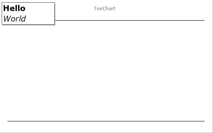

yes, there is a simple, although not obvious, hack you can use. Here's the MyAnnotation class:
  public class MyAnnotation : Annotation
    public MyAnnotation(Chart c) : base(c) { }
    protected override void DrawString(Graphics3D g, int x, int y, int t, int tmpHeight, string[] s)
      g.TextOut(x, y + (t - 1) * tmpHeight, 0, s[t - 1], Shape.TextFormat == TextFormat.Html);
And here it is used:
      MyAnnotation tool = new MyAnnotation(tChart1.Chart);
      tool.Shape.TextFormat = TextFormat.Html;
      tool.Shape.Font.Size = 20;
      tool.Text = "<b>Hello</b>" + Utils.NewLine + "<i>World</i>";
which gives me the following:
