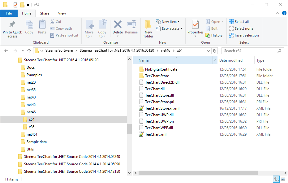

tt54321 wrote:I have a similar issue when I run my program which needs to be 64 bit. Is this an issue with TeeChart or has it not installed correctly on my machine?
Are you referencing the x64 builds of TeeChart.WPF.dll? E.g.
