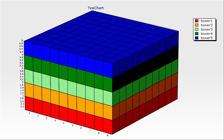

We want to draw curve like below image
It contains five layers as shown in different color.

Many apologies for the delay in replying to your question. You could use the Tower Series, e.g.
      for (int i = 0; i < 5; i++)
        Tower s = (Tower)tChart1.Series.Add(typeof(Tower));
        s.UseColorRange = false;
        s.UsePalette = false;
        s.UseOrigin = true;
        s.Origin = i;
        s.Stacked = true;
      tChart1[0].Color = Color.Red;
      tChart1[1].Color = Color.Orange;
      tChart1[2].Color = Color.LightGreen;
      tChart1[3].Color = Color.Green;
      tChart1[4].Color = Color.Blue;
      for (int x = 0; x < 10; x++)
        for (int z = 0; z < 10; z++)
          for (int i = 0; i < tChart1.Series.Count; i++)
            ((Tower)tChart1[i]).Add(x, 1, z);
      tChart1.Tools.Add(typeof(Rotate));
which can give you:
