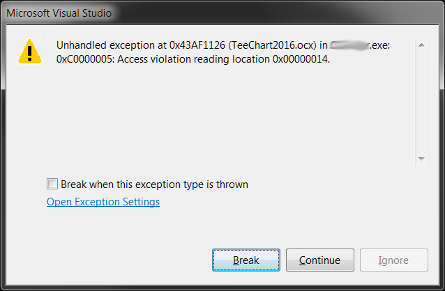

Using VS2012 C++ code line:
gauge.GetRanges().GetItems(0);
causes an access violation when InvokeHelper is called:

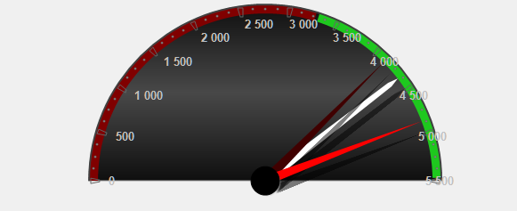

Another question. Is it possible to make axis labels drawn so that they are always inside face area not over axis area:
This does not look good!

Tero wrote:Using VS2012 C++ code line:
I've reproduced that problem with VC++, while it seems to work fine in VB6.
http://bugs.teechart.net/show_bug.cgi?id=1635
Tero wrote:Another question. Is it possible to make axis labels drawn so that they are always inside face area not over axis area:
It seems to be this issue:
http://bugs.teechart.net/show_bug.cgi?id=833
